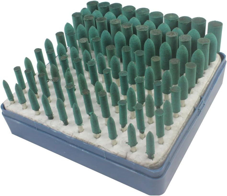

Wow. That's what, $300 in kits on the stove top?
My budget is closer to finding a 30 year old pack of ink pen erasers in a desk drawer and trying to twist the threaded mandrel (from harbor freight) into them.

You don't have to spend 300 bucks to get a good selection of rubberized abrasives .That is providing you aren't trying to fill a 5 gallon bucket full .Mac Master-Carr for example are sold 10 to a package at around 65-80 cents a pop with the arbors around 5 bucks a pop .25-30 bucks worth would do a lot of work . Now then already mounted on arbors are much higher per piece as would be expected .By the way if you go that route I'd suggest buying extra arbors because you can bend them . There might be less expensive sources in addition which I haven't researched .
