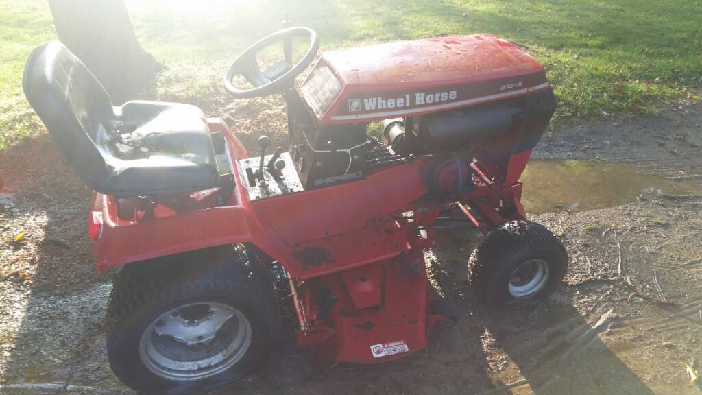

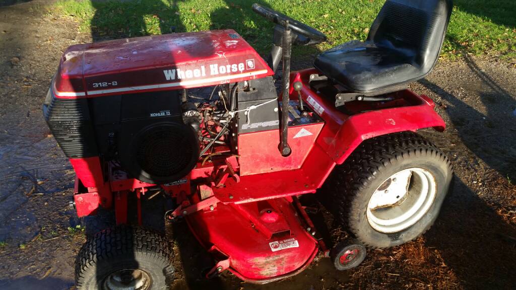

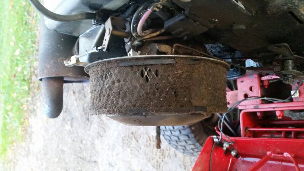

Just got this for free from my dad. Last time he ran it, it burned about 1qt per hour of oil. It reads 346 hours. The deck ran great last time. He kept everything greased, but he just never changed the oil or cleaned/changed the air filter. It has a Kohler engine...
My question is should I rebuild this engine or try to buy a running replacement. I got it to sputter once after pouring a bit of gas down the hole after I changed the plug. Compression seems quite low judging by how fast the starter spins it over.
Any links for engine parts or other g ood info is appreciated :)

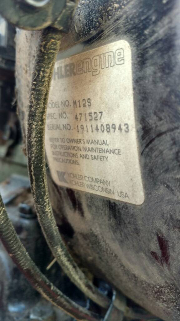

Put up a pic of the engine model tag. It should be under the carb somewhere.
