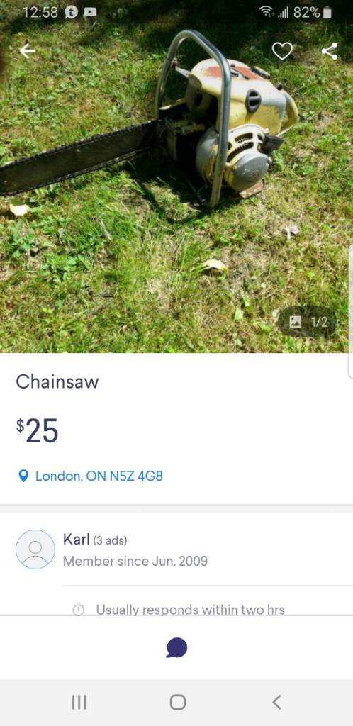

What modle saw is this?

Just windering what saw this is. Add says in working condition.

looks like an old pioneer maybe? cool wall hanger for $25

They are very prone to having stripped spark plug threads, check that before buying if you don`t want an expensive repair on your hands. A regular spark plug repair threader for the kits cannot thread in before it hits the top of the combustion chamber on these saws. I had to cut and shorten one and have another to start the thread, use the short one like a bottoming tap to complete the thread cutting. Two kits equals a good bit of Loonies.

I got er. I didnt look it over. He said it runs. I figured for 25 bucks its just a cool old peace of history. I love these big old saws. Will have a look at it later when i get home if its not too hot out. Its crazy hot out.

Well it will fire with fuel in plug hole. Fuel onnoff valve was plugged solid. Blew that crap out and got fuel flowin to carb. The old guy says he hadnit runnin last year. It looks like it hasnt ran in ten years lol. May have to pull carb apart and clean. Not sure if i can get a carb kit still but will have to do a little pokin around to see. Im also not sure what os choke on and off. Its the old lever lookin style. Guess i will find out if o pull carb apart.
