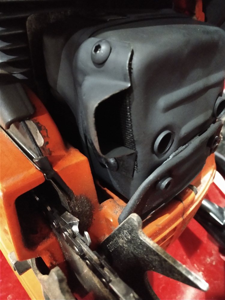

That’s what i will do - i need info on how to clean up oem cylinder - i have that ball with fingers ( forgot the name) used for cleaning up cylinder and i have a regular hone. Suggestions welcomed and also where is best place to buy meteor piston rings and a good open muffler. Tell me about deleting gasket - literally just leave it off and put nothing under cylinder ?
Piston- https://rover.ebay.com/rover/0/0/0?mpre=https://www.ebay.com/ulk/itm/181764181950
Base gasket delete sealant- https://rover.ebay.com/rover/0/0/0?mpre=https://www.ebay.com/ulk/itm/172366134240
Don't try using permatex/silicone it isn't the same thing.
Muffler mod-
