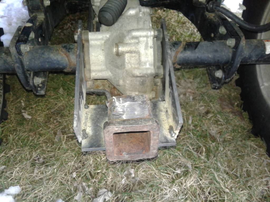

Had to build a hitch for atv. Tore factory one off pulling logs.
