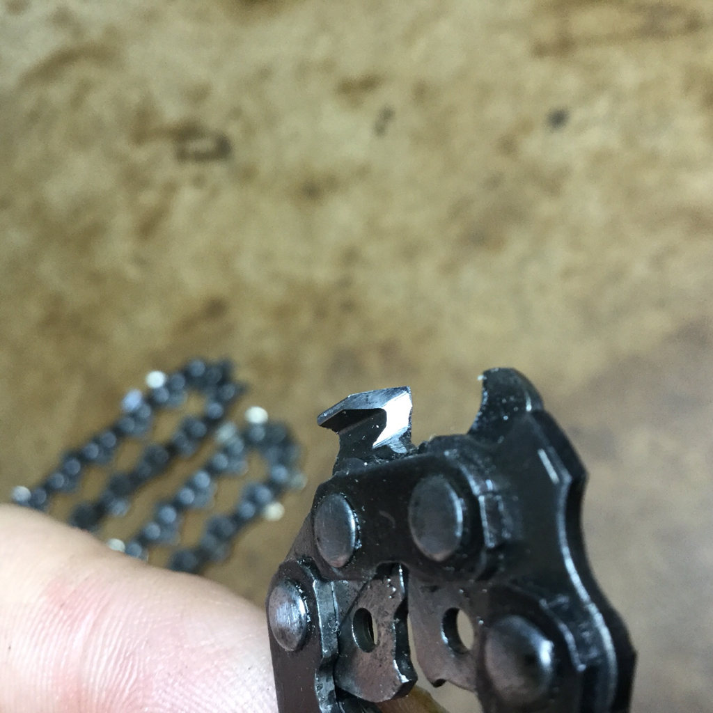

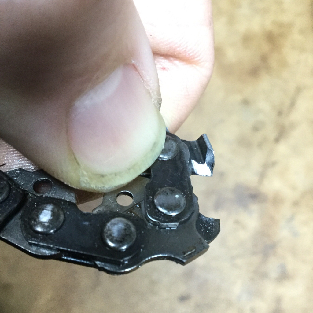

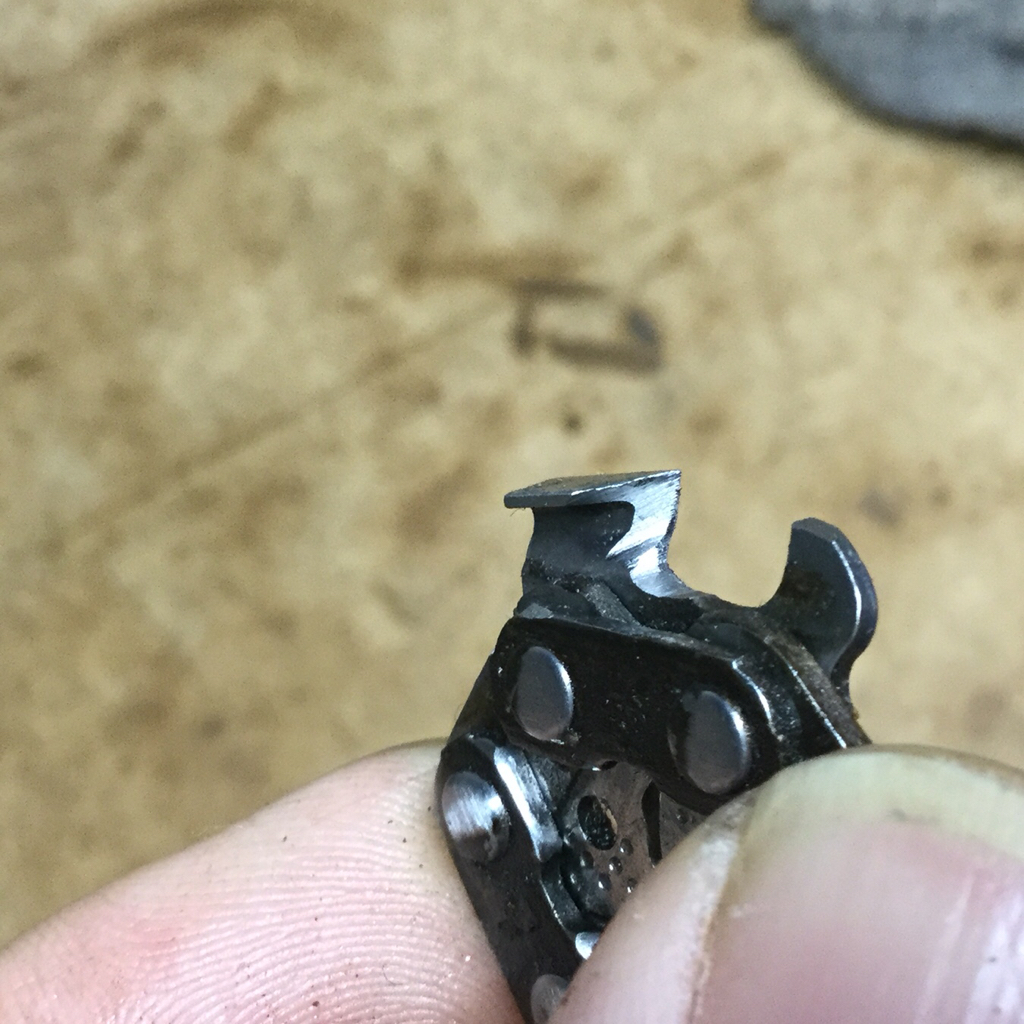

I had read that stihl chain is harder to convert to square file but I thought it was better to start out harder. Just a big FU to myself.
It’s been some good practice.
These are my 1st attempts.

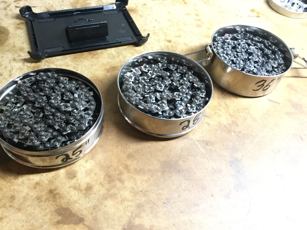

Bonus photo shows how I transport my chains.
Pretty neat and handy.

Stepping up this post. To OP when learning to square file you need some ledge in your gullet to support and guide the file. Looks like you cleaned out the gullet with the round file too much and lost your ledge. Just leave a mm or two.(.040"-.080")
About hard cutters, in all my years filing Stihl chain from 71PM to 46HM harvestor I have never come upon a hard cutter .
You may have picked up some metal in your wood and a couple of cutters have it stuck under their cutting edges.
Nice storage containers.

Thanks man, that helps a lot.
I’ve been keeping up with my Oregon full skip square CL chain and have been doing alright but gave up on the conversion from rs to square.
Might be time for a restart.

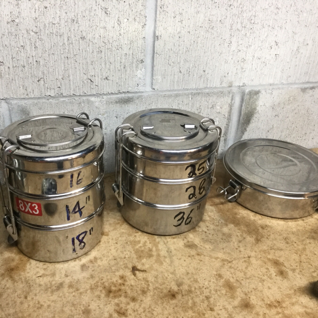

What cind of can is That, I don't recognize it,,, I think that's a Great idea, & I would like to copy that...

They’re called
tiffin box
And they use them in India for lunch.
I’ve got a two 3 tier ones
And the wider the better.

Thank you Very Much for the information, I'm afraid that I will have to Copy that...

I cram as many as I think I’ll need.
Smaller chains, say 24” and under you can squeeze in a couple per section.
28 to 36” only one, but they make a few sizes soo ymmv.
