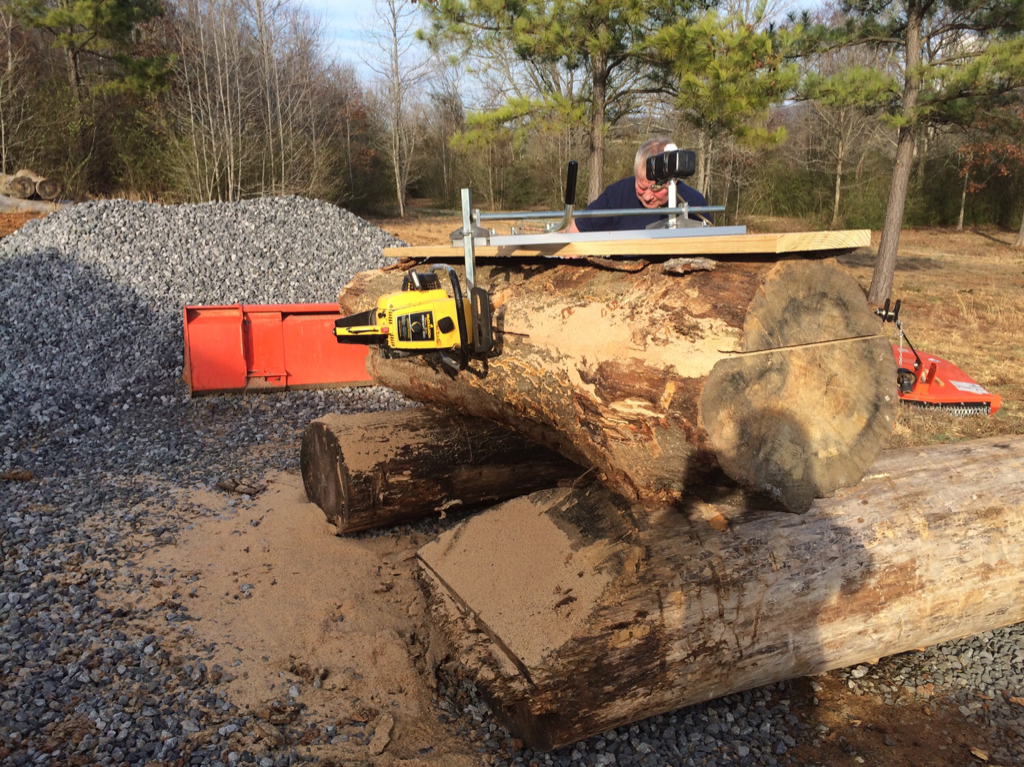

What type of chain setup do you use for the milling?

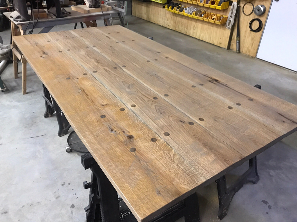

3/8 with 10° angle. Cuts pretty good. Haven't done any projects lately but the last thing I did was make the wife an oak dining room table. She wanted a rough looking "rustic" table. Good thing because it would look rough even if I tried to make it look good.

Oh, it cuts about a foot a minute in the bigger hard woods. It will rip pine and cedar pretty quick.
This is the beginnings of the table top. It may be cutting more than a foot a minute but it's still slow.
The only issues I have is the air filters getting dirty quickly and the cut in the video above takes a full tank of fuel for one pass. I set the saw a little rich and I use 32:1 which is no different than any other two stroke I have. I rotate the saws often so I don't wear one out too quick. My father just got a 15hp woodmiser so my chainsaw milling days have just about completely stopped.

Do you just use basic 3/8's ground to 10° or ripping chain with the narrower cutters?

If you are getting a foot a minute that's not bad especially blowing sawdust .I can only get about that in oak on a Mac 125 using standard 30 degree chisel chain which is a lot faster than rip chain .My milling days were very short lived after I found out how much work it was .

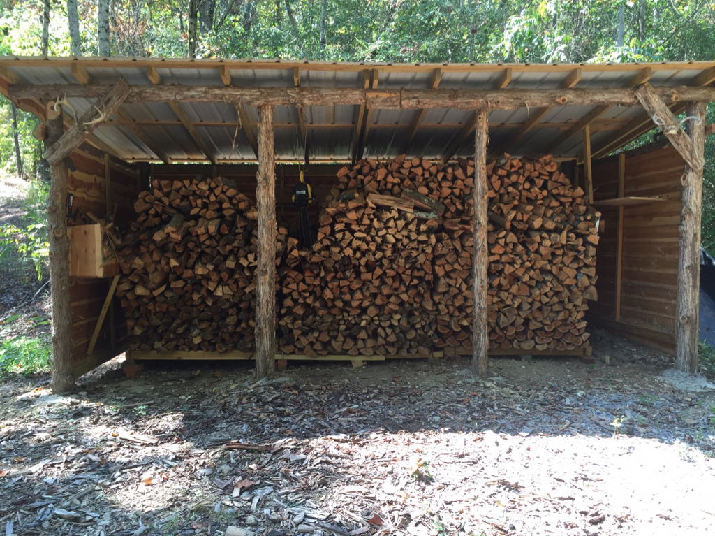

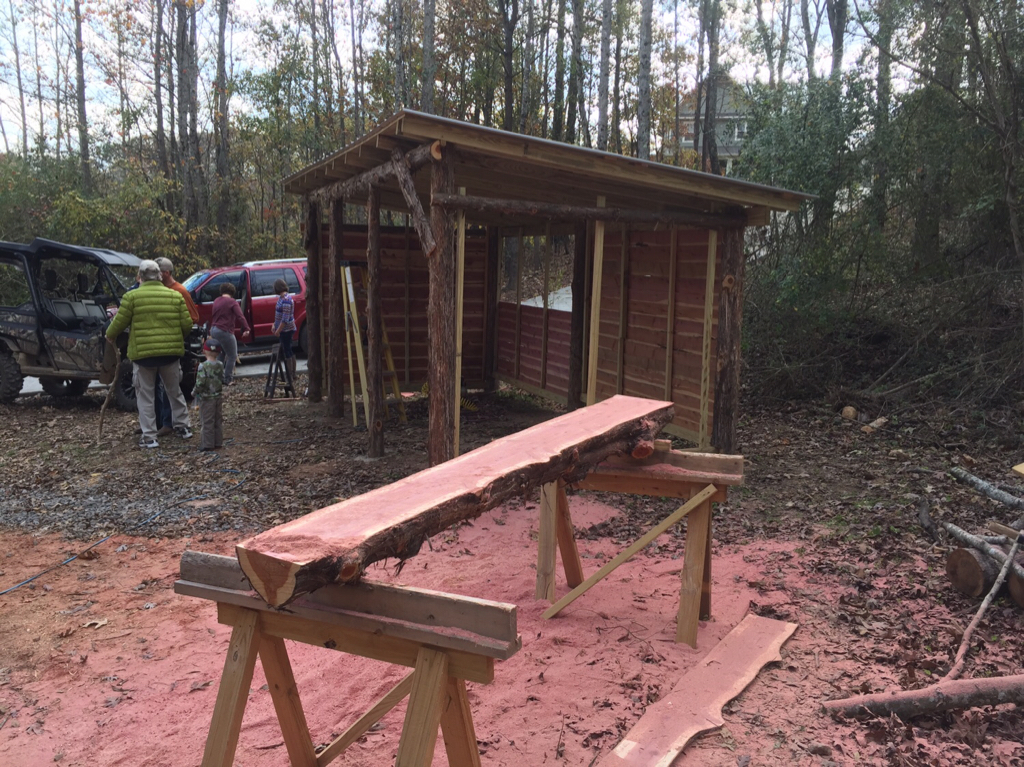

A lot of the time my job keeps me in doors working and often in other countries like somewhere in Central America or another foreign country like New Jersey. It's nice to come home and build a wood shed with out hardly buying anything. It's a good release.
