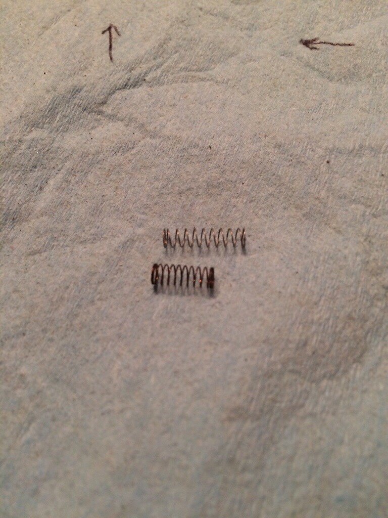

Just log tuned the MS360 that I replaced the carburetor on yesterday with an aftermarket version. One thing I noticed was that when turning the screws it seemed that it took a pretty long swing to get it to change, not that it's necessarily a bad thing, ran fine otherwise. Started in two pulls with the factory setting and stayed running, not too bad I'd say, one point for the aftermarket.
Found the same Steve on non OEM carbs iv put on Stihl 024 saws iv done .
I've found the same sort of thing on the carb that came with my Hutzel/Farmertec MS361.
It seems the Asians feel one size fits all for metering lever springs.
Saw started/ran much better with the short one.
Best running 60 class saw I've put together.
Slabs are more useful than cookies.
Asian clone.
Il have a compare with the pop off pressure on a OEM carb and a Non OEM carb and see if there is a big difference indicating what the spring pressure is like.
