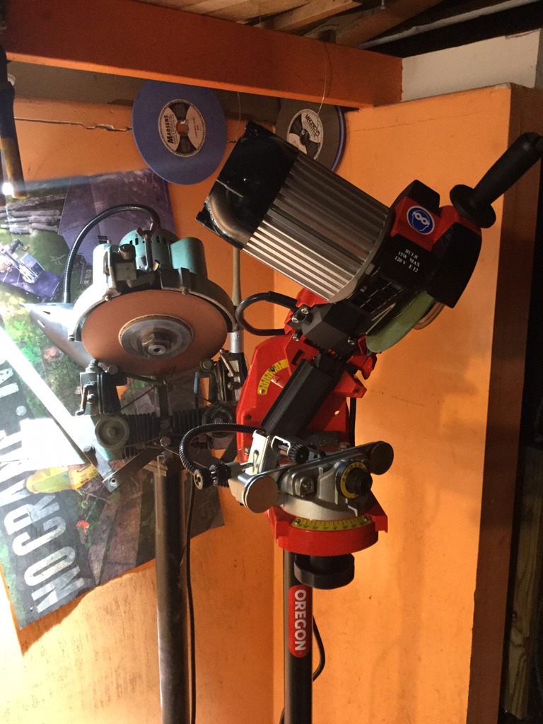

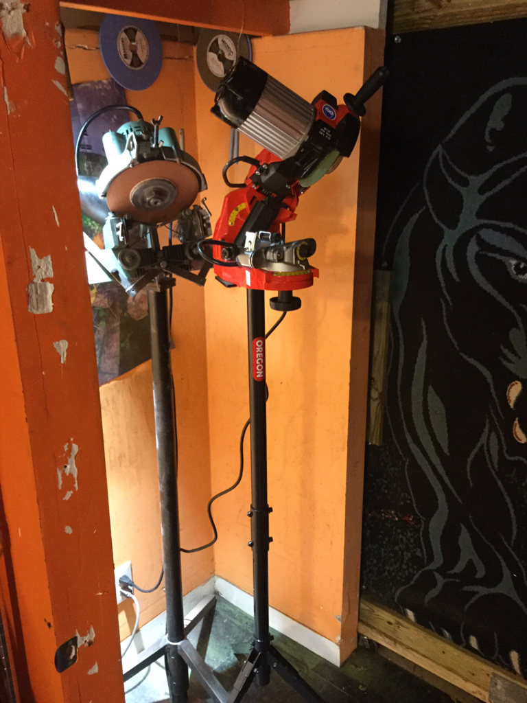

Got the Oregon stand coming for my still strapped down super jolly today cause bench space is lacking and too short for working.
Seems no one has mentioned which hydraulic oil, how much and how they added it.
Has anyone had any issues with this?
Any insight ope?
Also, yes, I got one as well.
Couldn’t resist.

The instructions show how to do it. Need a big syringe (find them at a farm store) or a pump can oiler.
Any hydraulic fluid will work. Automatic trans fluid, tractor hydraulic fluid, or similar.
It comes with the cylinder already filled.
