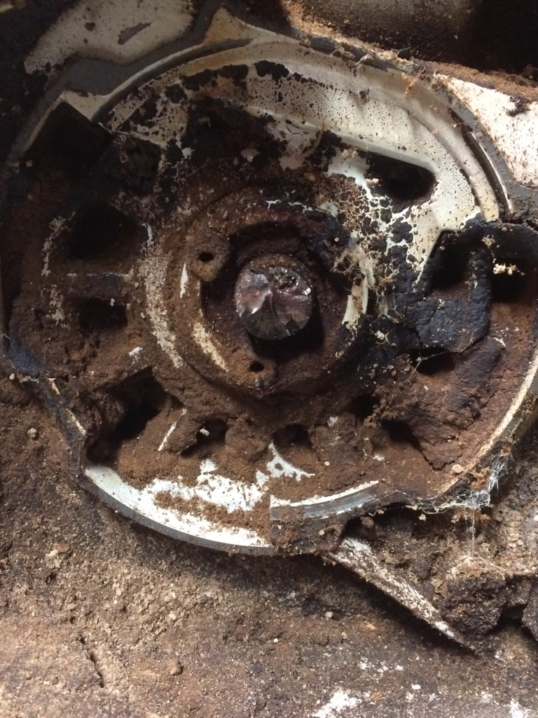

Jonsered 2050
Looked low use had compression but when I looked through the plug hole. I could see metal chunks but didn't look scored. Took the muffler off. It still had machine marks on the ex side of the piston. When I took the intake off I noticed a problem. Not much damage on the intake. Notice the brass in the crank case
