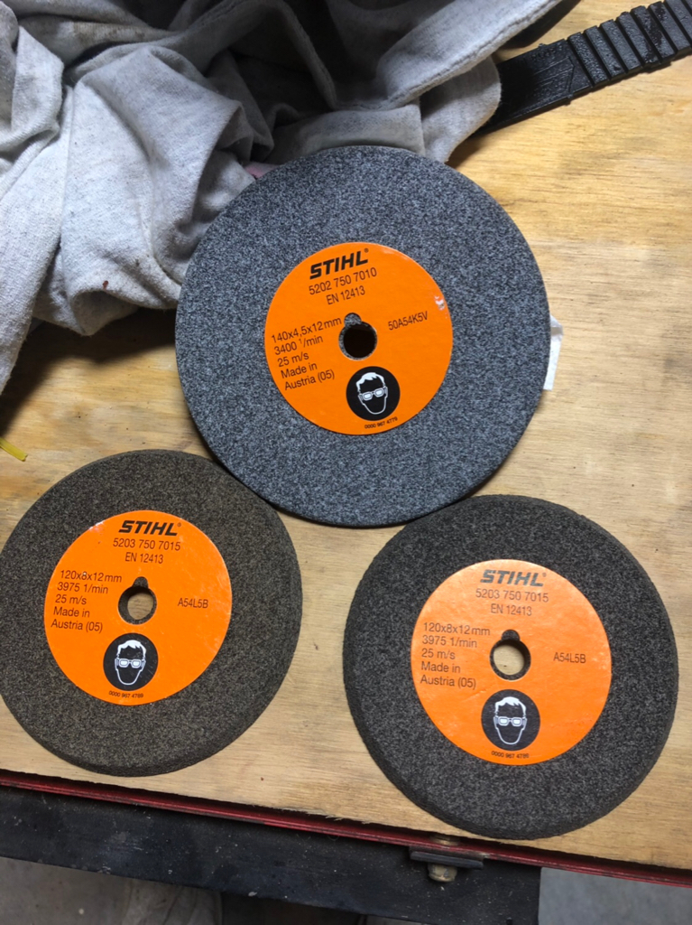

how are the like on the rakers and are the accurate with the heights
It does a great job on rakers but I haven’t use the supplied wheel on rakers yet .
I stand the head up to 3* and use .404 wheel to knock them down
The plus to this is the .404 wheel is a larger diameter and hard compound and after going through a 6’ chain I don’t see but a little gain in height but still can get the same filler gauge in there
The down side is you have to change the head angle
The supplied raker wheel you leave the head setting the same but my dealer said the compound of the wheel is softer and a smaller diameter
I’m going to try this wheel in a few days to see if I can see the difference for myself
mitchm1
6:22 AM
8621
Feb 3, 2019
88
232
You can see the color difference but at this point I need to try it and see
Stihl even make the pink wheels for Holtec company that they are in cahoots with
They are the only ones they sell there scratcher chains too and the pink wheels
I’m trying to get a pink wheel to see how it compares to the Oregon type
