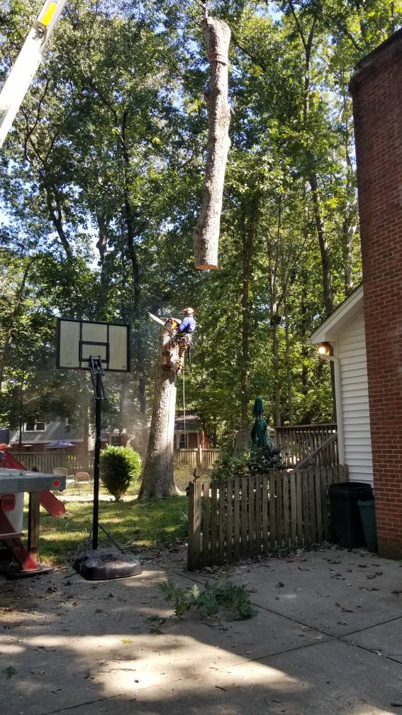

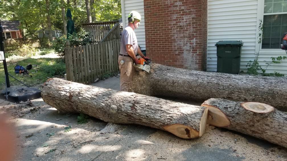

Owner put it right back to work... was able to take the whole stem off easily for the final pick. Root flare took all of the 123 dl of .404.

Cutting white oak like that is a great test of saw oilers. Did he send that tree to the mill? Nice stick.
Had metal in the first log. The logs were not that great. All of his logs go to a local mill as that is where he parks his equipment. I bet Steve [mill owner] makes that one into firewood. I do all of their saw work too.
