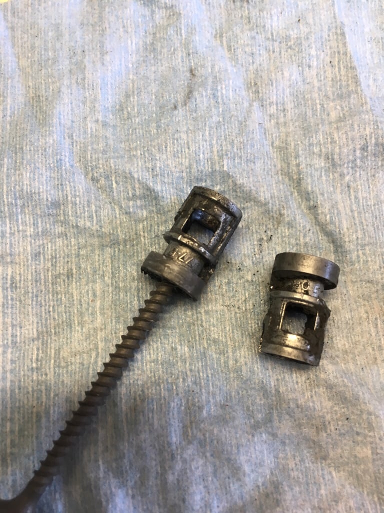

Low side damn near fell out. I had to hold the screw with pliers and tap on the carb body with my tiny hammer for the high side.
Do I need to save them?
‘Eff the EPA !
I would...if they came out without messing up the plastic around the jet screw , then they should go back in reverse of extraction. I wouldn't know if these needles move much without the caps. Some do fine , some just rotate to easy without the limiter. Getting new caps is not so easy here .

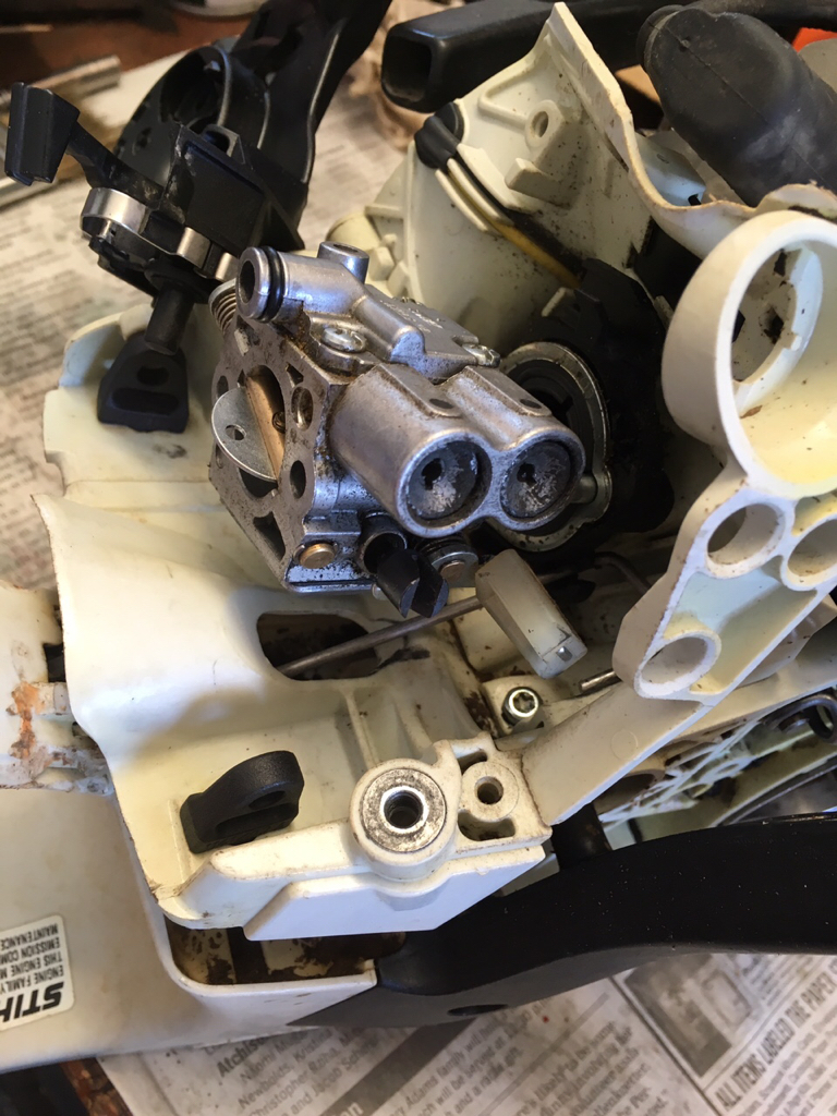

How many turns out L & H?
This thing is faking on its face in the cut.
Likely a fuel delivery problem (filter, line or carb inlet screen).
The older carb on the 251 was ..without caps ..L =1 out and H=1 1/2 . I think the screws on the carb you have with the metal caps have a finer pitch thread so you may find more turns out needed. A lot of the current Zama carbs have gone this way with many over 2 turns out on the H.

Try the high side richer then. [emoji1696]
Also see if the exhaust is coked up. [emoji848]
Yup...it should do "something" ether way before you decide if a different carb is the way forward.
