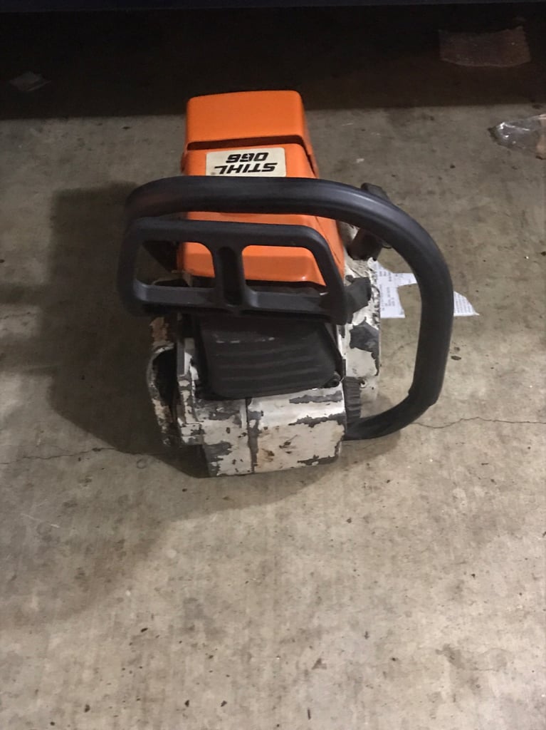

Stihl 066, a while back, I installed a new oem clutch side bearing, a 6203 c3 nachi quest bearing for the flywheel side. I also replaced the gaskets, seals and air filter cover, those are also oem. I replaced the impulse line and the upper fuel line, impulse line is oem. The saw has a very nice ms650 Cylinder and a new oem piston, wrist pin bearing, rings and clips. I first tried a new aftermarket (Chinese) carburetor on it and it would run but wouldn’t rev up, no matter how I adjusted it. I then took a used carburetor and rebuilt it. Then the saw wouldn’t run. Then I tried a brand new Tillotson carburetor on it. It still wouldn’t run. The saw does have the dual keyway flywheel on it. I don’t need a saw this big and I’m tired of fooling with it. I’m sure with a little tinkering you can get it going. $400 plus shipping.

Dual keyway and it won't run? You sure it's on the right setting for the coil?

I did some more checking and I believe the problem is intermittent/ weak spark. Next I guess I’ll see what coil fits it. The saw is still up for sale however.

I changed the coil, saw now runs but I still can’t find the issue.

Is it a red light? Do you have the right coil flywheel combo on it? It seems like it is limiting out. Especially if it is the same issue for all 3 carbs you have used. To me it does not sound like over fueling or starving it. Post the part numbers for coil and flywheel as well as what slot you have the flywheel on if it is dual.

You replaced upper fuel line and impulse, you said the impulse was oem but didn’t say if the fuel line was. But if it’s an aftermarket line I’m wondering if it’s sucking flat starving the saw possibly? And if it has a red light coil weren’t they known to get weak and reduce the rpms as they go?
