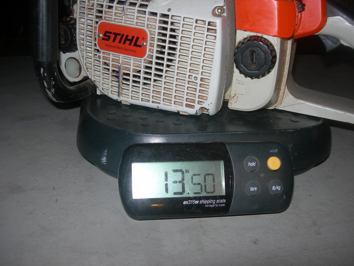

Have you weighed that thing? I am curious if it is any lighter than a non HD 044.
It should be just about the same weight as an 036. I can’t imagine the slightly larger cylinder and piston weigh much.

An 036 doesn't have an HD filter. That adds over half a pound to the 044 when added. I'm just curious.
In other words, it seems like a lot of effort to end up with something that may be less powerful and reliable than a bone stock non HD 044, that weighs the same, and cost a whole lot more in time, effort, and money. Just sayin...

I cant imagine that it weighs the same as the 044? I could be wrong but I have both saws and there's at the very least a substantial size difference. Just like the Swedish people are always touting, " it feels NIMBLE " because I know I'm always doing parkour and circus do'lay stuff with my running chainsaws.
Was going to ask the same thing.
I wanted to compare it to a 462 though. To me the 462 doesnt seem that much heavier or harder to handle than a 261 but has WAY more woopow. I end up reaching for my 462 more than any other saw it seems but I have no 60cc saws.

It weighs less than my 044. I would assume it’s a few oz heavier than a stock 036. It’s actually my favorite saw. It always starts right up. I only built it to just do it for fun. I didn’t know if it could be done. No other reason. I had a Bottom end with a bad crank. So I built it with a Chinese crank and bearings. Piston/cylinder and milling I got from mattyo
