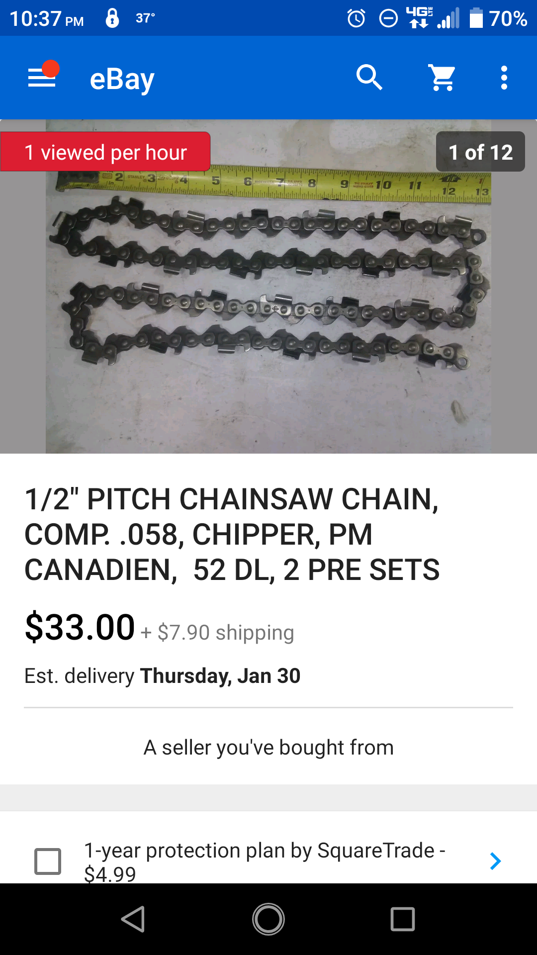

I'm in the process of buying some 1/2 pitch chipper chain on fleabay and what do I need to break and spin it? It is coming with a few presets and ties. Can it be done with a .404 spinner?

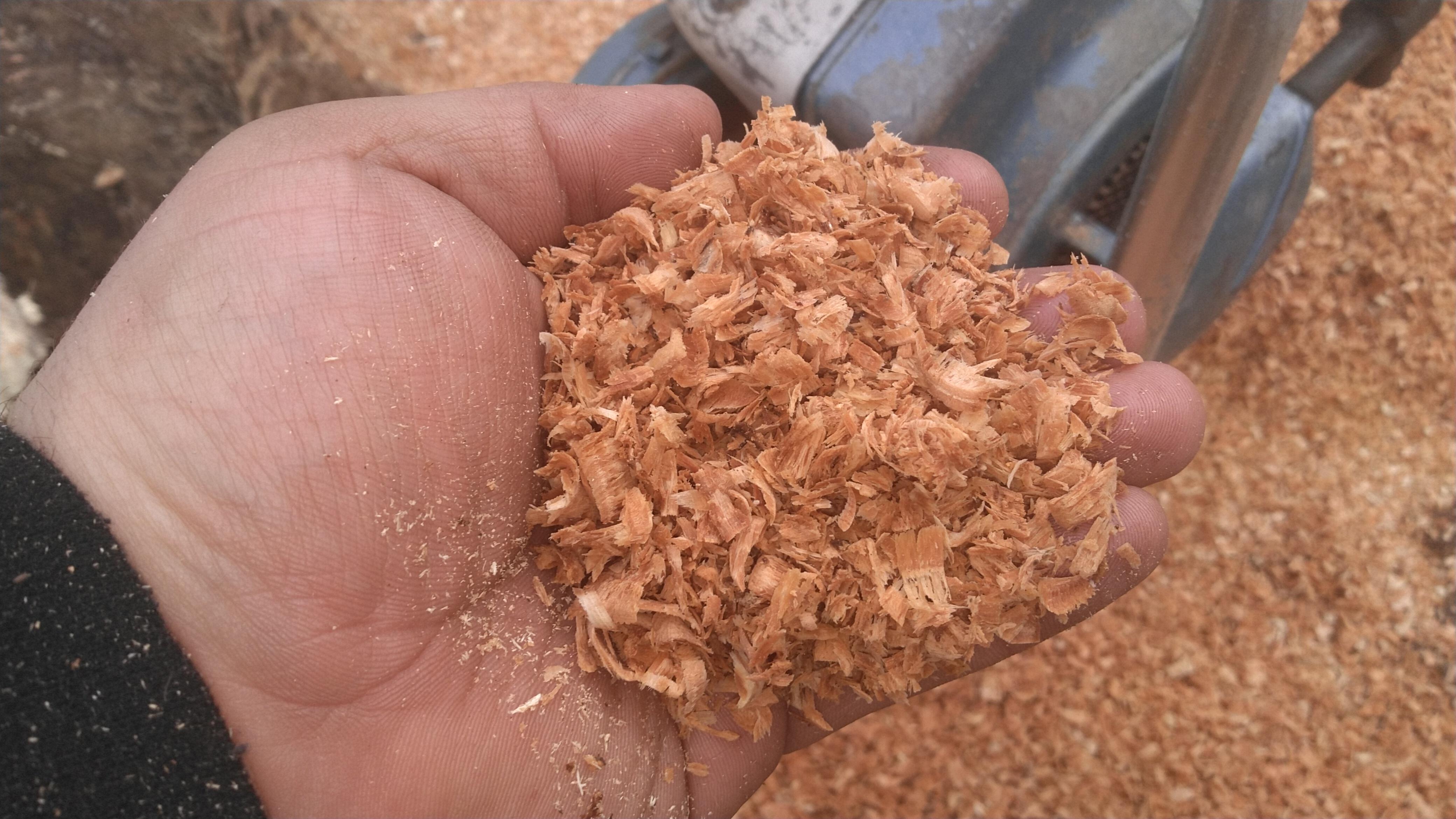

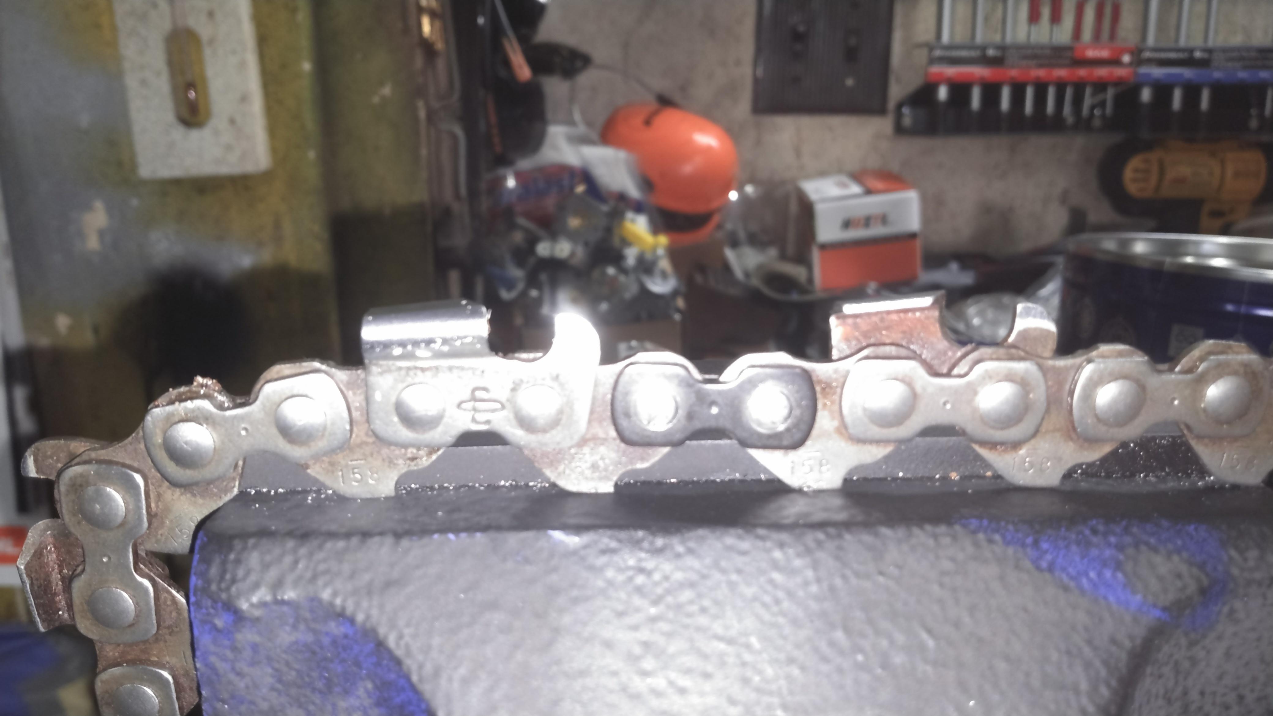

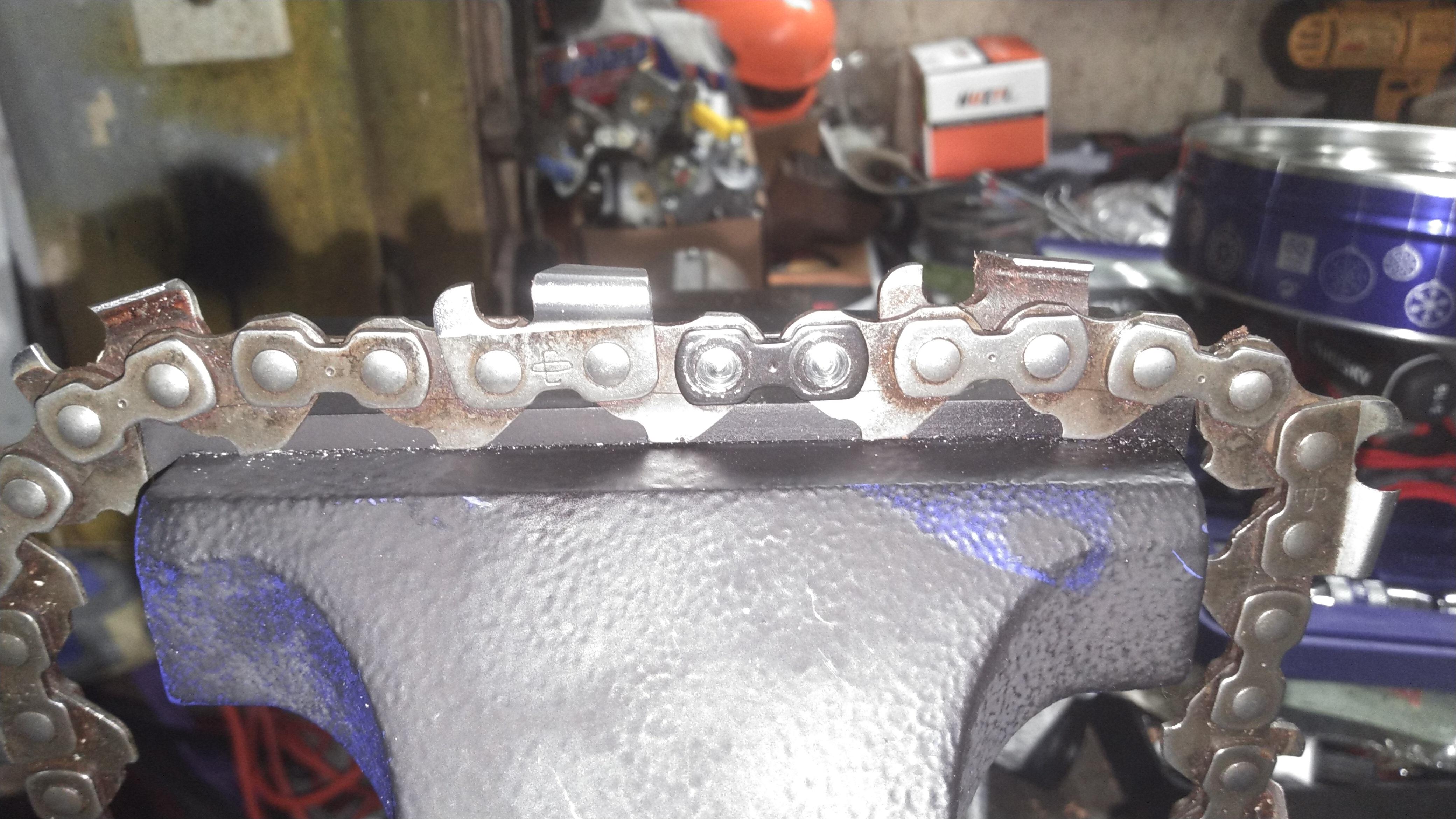

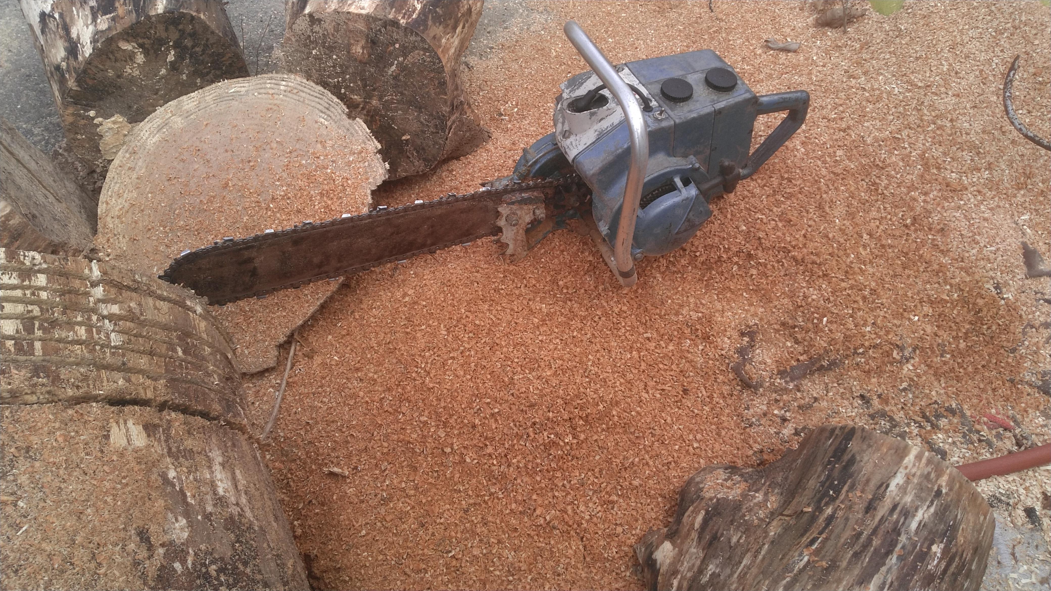

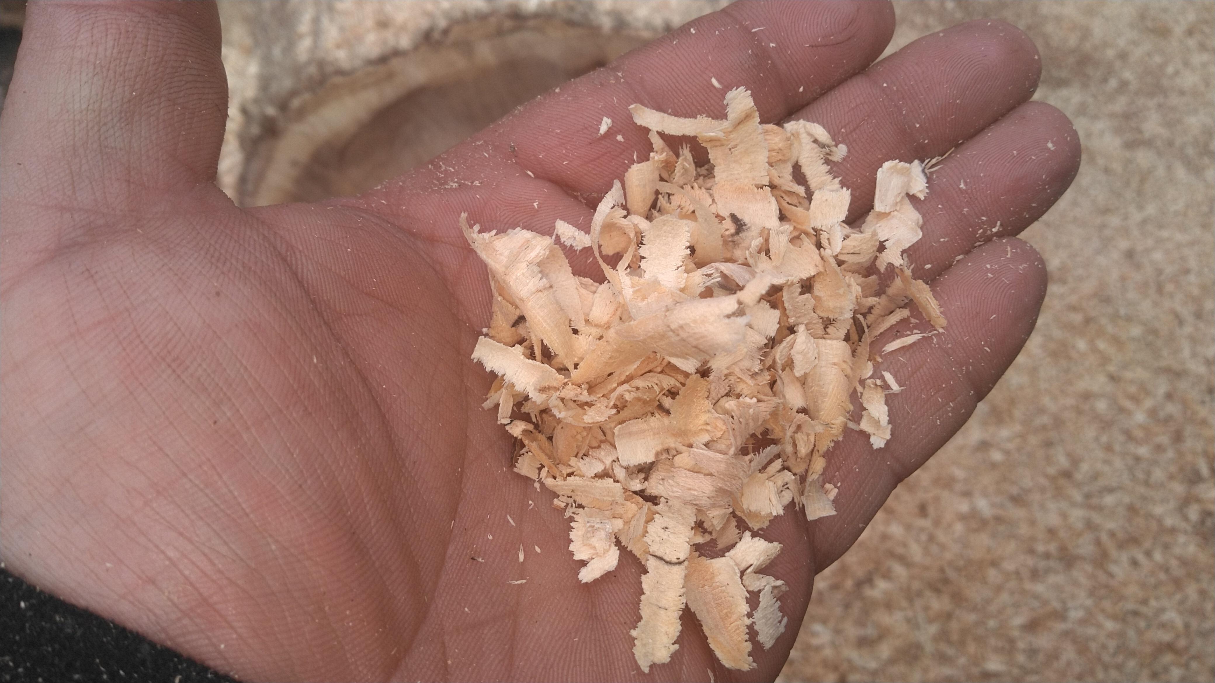

Got together with @SOS Ridgerider today and his Harbor Freight spinner breaker worked perfectly for the 1/2 pitch rivets. A little bit of touch up with a 1/4" file and some adjustments to the carburetor had it running and cutting well. Slow and loud but gets the job done!
