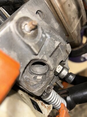

I have a 441 that has been kind of a basket case. When I bought it, it had a couple pieces missing including the spark plug. Fast forward to now and I have it rebuilt. I was going to put a spark plug in and found out the socket for the plug is bigger than a BPMR7A. Anyone know if this is typical and what spark plug fits?BE8CA9D1-9EC8-406A-8A6B-F91B2D85B028.jpeg

I'm going to guess the threads are torn out, if so I can repair it 4 U.
I thought that was the case and maybe at one time it was but the threads seem to be in great shape. 90F1D285-AB7F-4051-B535-A1AA49A1A68B.jpegFB4DC2F8-47EC-4CFD-A476-ED29C3E6716D.jpeg
Kind of hard to tell in the pictures but the threads are in great shape

The insert came off with the plug, it's already been repaired before, just not good enough to stay put. Look on the old plug if you still have it.
