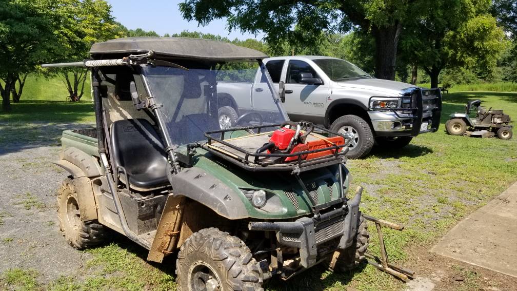

Had my 643ip on downed tree duty today while working on treestands.
Is the 643ip everything the specs suggest it is?
I’ve been thinking of a new chainsaw for my Honda quad.
I think it is. It's very light, easy to start, cuts great and it's reliable. It's my go to saw for light clearing, cutting paths and treestand work. Finding one might be the only issue.
Sent from my SM-N975U using Tapatalk
Indeed, I have never seen one, or know of anyone who has one.
As cheap & obviously cheaply built as the MS170/18o is I'm finding it hard to upgrade from for this purpose, as any seriously better saw very quickly jumps in weight to the likes of a 346xp, 2153, 026, Solo 650, still lite, but not quite what my ocd wants.
