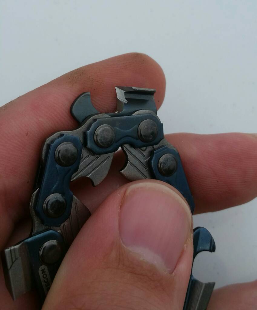

Makes a dandy fang don't it?He knows I’d outbid you on it.
I hang onto the chain to keep the tooth back against the stop. It seems to steady it some on my rig...Good Good nice view I may even be able to use that perspective for better progress
Me two. Tried it that way from reading whole thread three times lol that looks like a white wheel, is that roughing down to the cutters that are smaller than a work chain?I hang onto the chain to keep the tooth back against the stop. It seems to steady it some on my rig...

I found a line between putting back pressure on chain to hold against stopper and pulling to hard and moving arm down.I hang onto the chain to keep the tooth back against the stop. It seems to steady it some on my rig...
