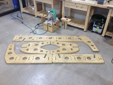

I'm building these one of these days:
http://lumberjocks.com/projects/96307
These probably work better than you would think. I'm guessing the holes are about weight reduction and add a distinct look...
I have a guy that works for me that builds horses out of 1x material that will hold a tank! I always made mine out of 2x6's for my heavy beams in the past. He talked me out of it...

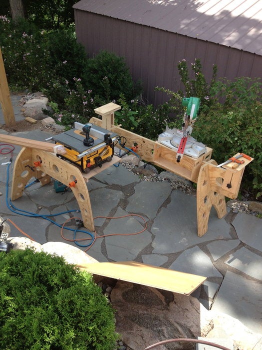

mbergeon
3:36 AM
1137
Apr 8, 2016
8
26
Mid MI
The holes lighten and also give you a spot to clamp to, also they are flat for putting in the truck or trailer
