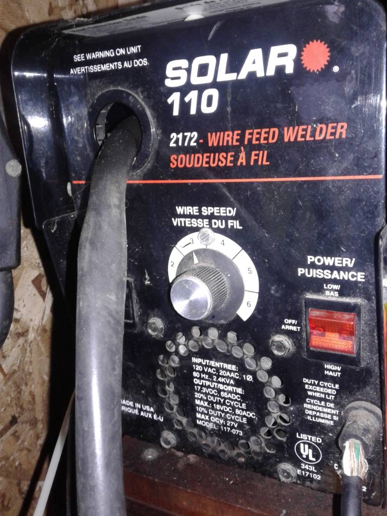

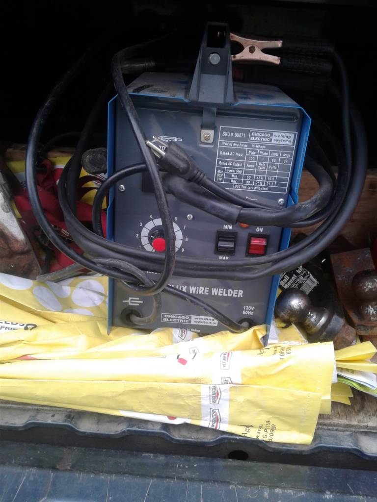

I would like to run hydro to my shed someday, not anytime soon. Probly not this year. But was just wanting some opinions on best way to do so.
Now i just run a heavy extention cord and that dont produce enough amps to run my welders properly.
Just wanting some advise on best way to get propper power supply to shed.
Would i need a sub pannel?
What guage wire to run from house.
House is only a 100 amp service.
Lenth of wire from house to shed would probly be about 80 feet.
What amps should i be looking to get out ther to run the small 110 volt welders.
