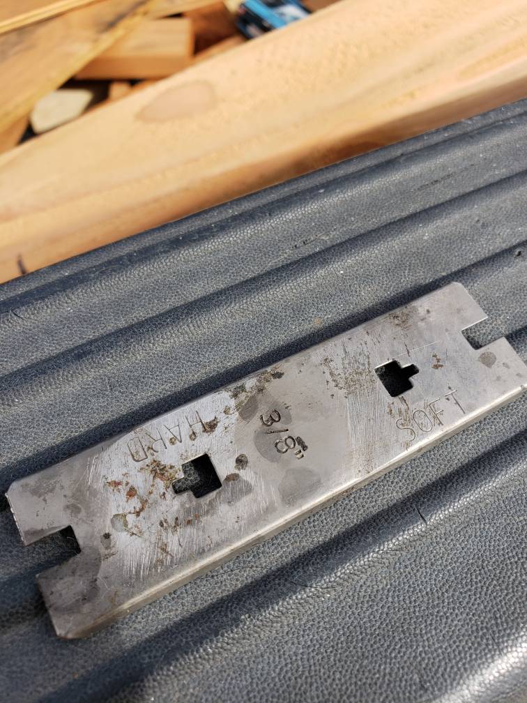

I use the husky plate on soft for all my depth gauges. They come in specific sizes but have used my 3/8ths on my 325 in a pinch and it worked alright. They wear out fast but have the best results imo.

This is the one I am speaking of. The wear occurs where the flat file runs, partially from excessive use but also I put to much pressure when filing. I've tried a lot of raker gauges and these are by far my favorite.

Yep. Not sure why the skip tooth would matter. Note that they are pitch specific.
Pretty sure it needs 3 cutters and rakers to sit on to "level" itself out, or atleast 2. So skip would have to big a gap between the next tooth and it would just sit on 1 cutter and raker and sort of teeter totter up and down.

I believe he is, that is the raker plate that I use. Easy to use, takes the raker height down progressively as the cutter wears and puts the contact point with the wood at the back of the raker.
