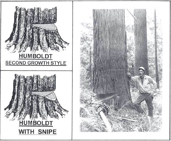

It looks like you're doing good Rob...just be conscientious of wood pull/fiber pull from your butt logs...wide face cuts will help avoid that, especially if you're falling a stick into an open space.
It also doesn't hurt if you have a clean lay to take a snipe from from one of your falling cuts - I usually do it on the angled cut, regardless of which style of face I'm using. It helps with fiber pull and can help get a stick down cleanly if you're falling into a tight shot or you have some limb clash with neighboring trees.

Thanks for the input and I'll put it to use. Trying not smash what I'm leaving is tough and definitely challenging. Lots of ugly leaners. In fact almost nothing is standing straight.
I am struggling with some butt tear up the side of my hinge often....Not sure what I can do to avoid that?

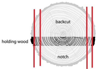

Always seen it after the notch.
Not a bad guide to the back cut placement as well.
In the Eastern hardwoods we do a lot of bore cutting to avoid pulling fibers..
Check this guy out.
