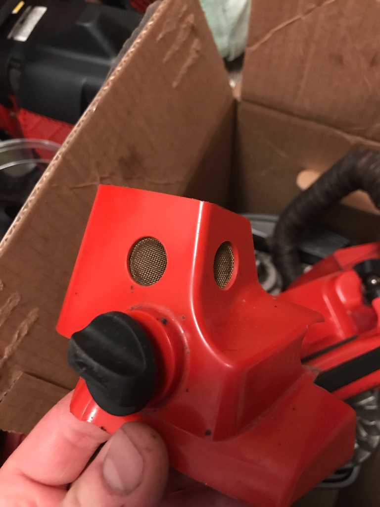

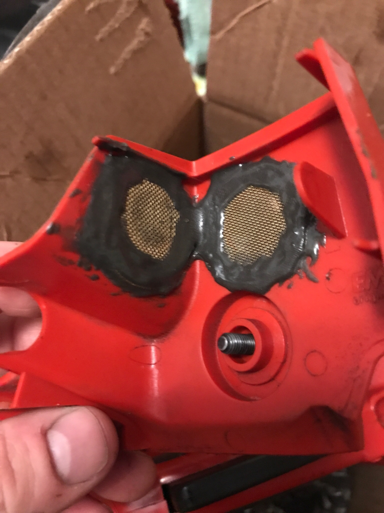

I can’t fix the long intake, but I did add some screens in the cover of mine that help. After adding the extra intake holes that bypassed the flywheel, I notice far less wood chips in the filter. It was the opposite of what I expected.

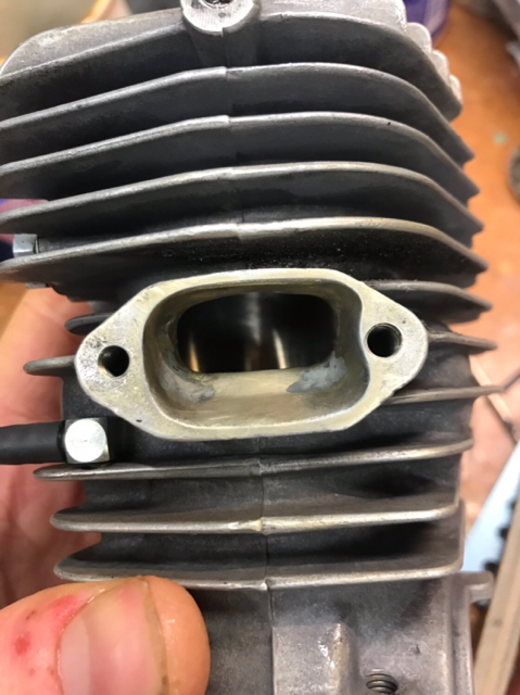

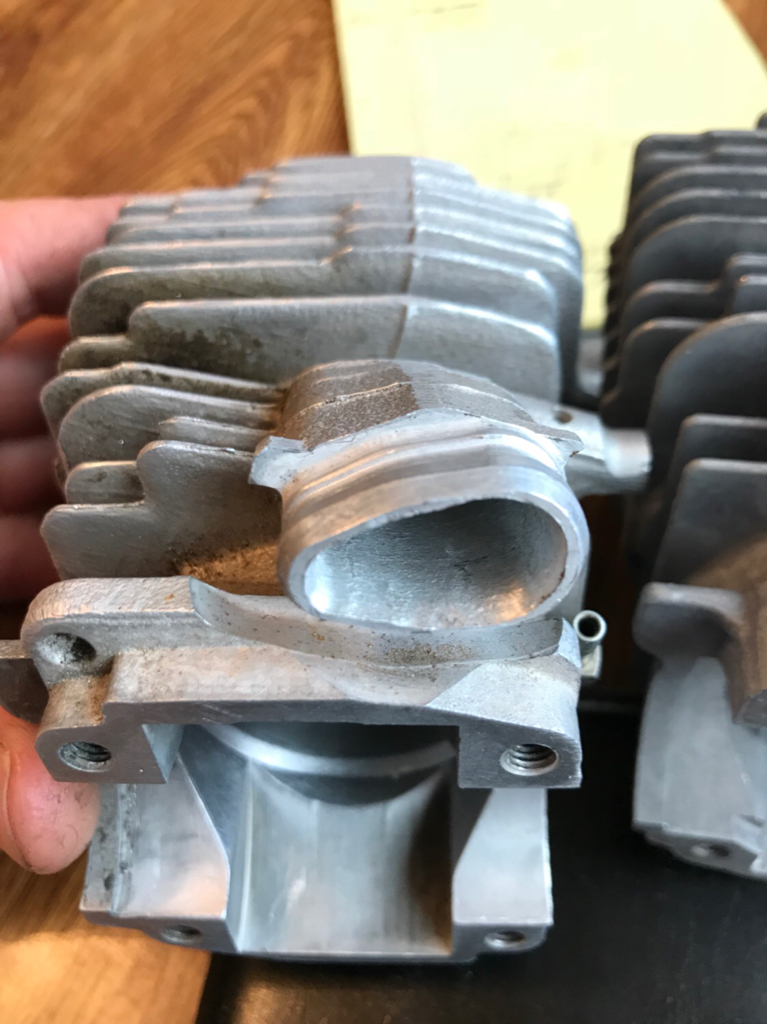

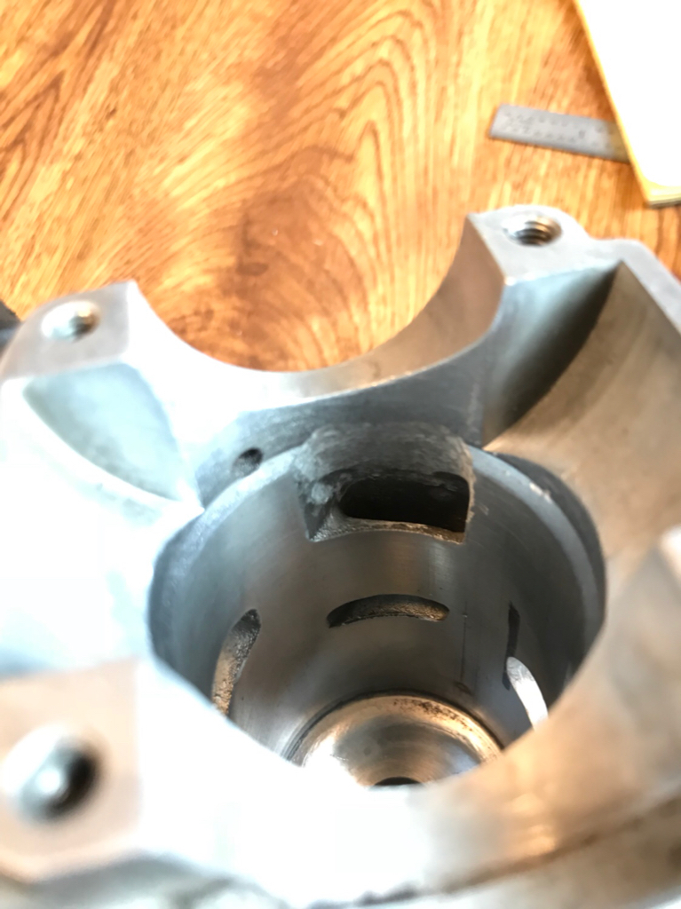

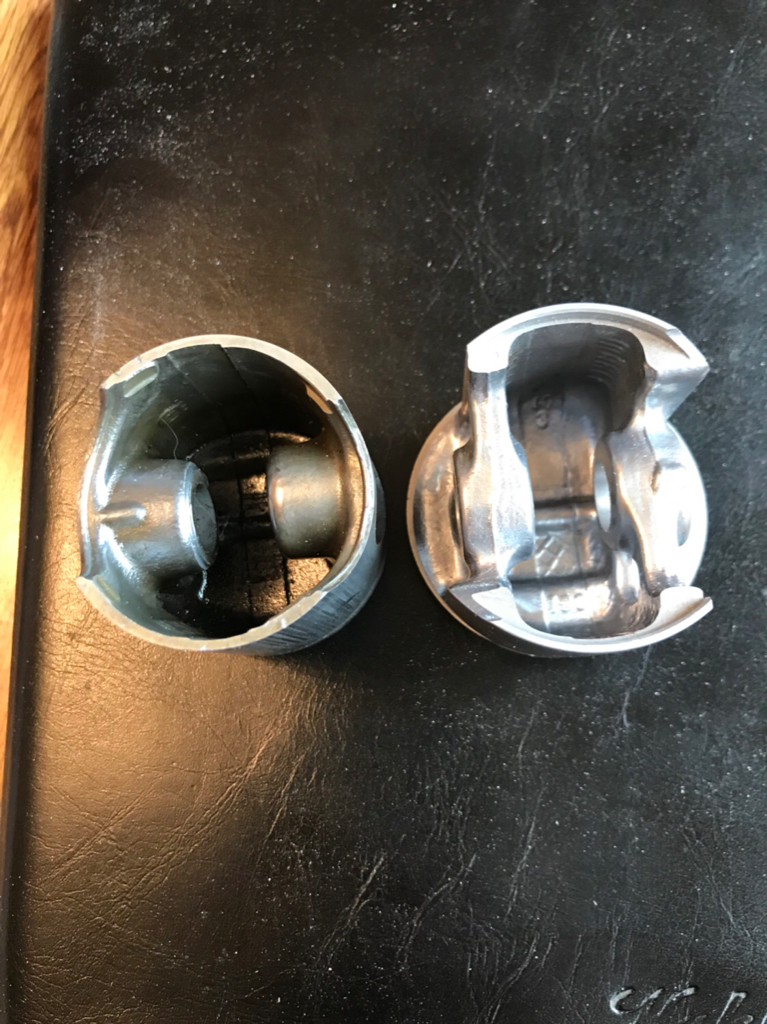

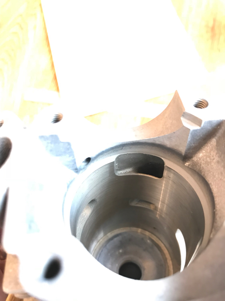

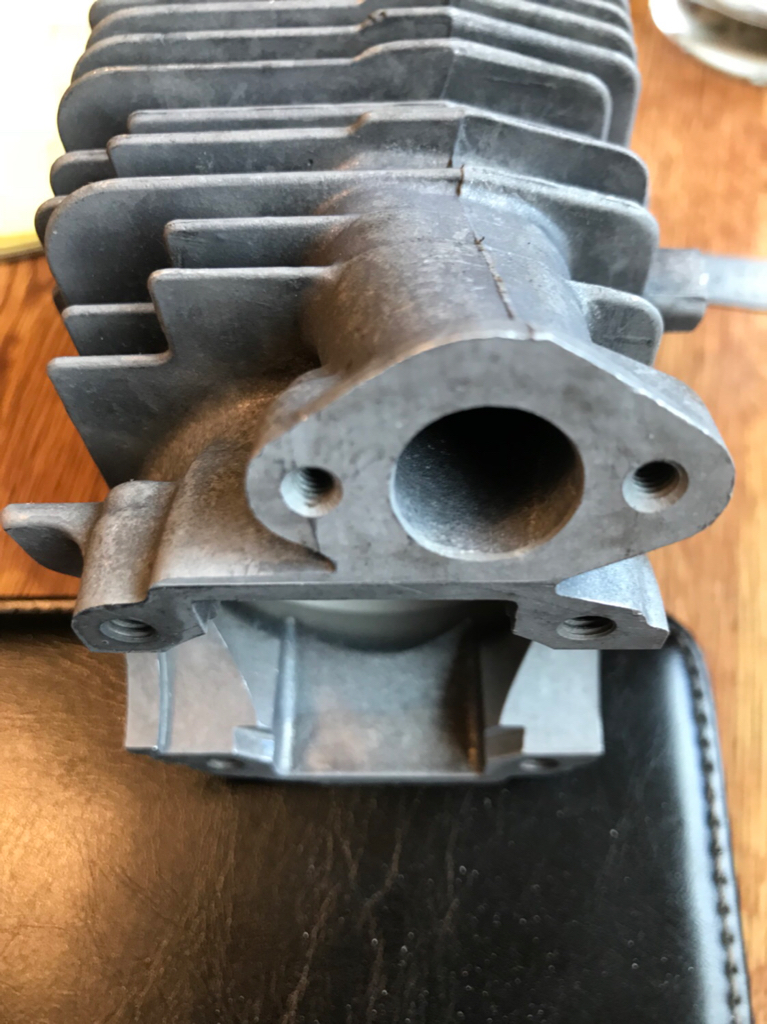

Alright, got the new cylinder and piston. The intake appears to be attached using a different method. Not sure if I should trim the cylinder to fit the intake or get another intake. Leaning towards another intake as that will be easier and look better in the end. Hope the intakes fit up to the carb the same?
The intake at the cylinder appears close in size to the 38cc top end (this is the cali version (45cc)). The intake track is very restrictive. Luckily there is room to improve that.
Exhaust is very similar on the cali cylinder but appears slightly higher. Almost seems to be slightly more open on the muffler side.
Piston on the cali is slightly heavier (.2oz). The cylinder on the cali is almost a full ounce lighter. The cali cylinder is a mahle and the stock is gilardoni.

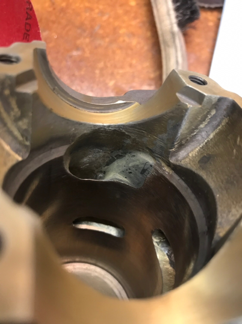

The two power defeating areas on the cali cylinder appear to be a very large combustion chamber and very tiny transfers. Transfers are like half the size of the 38cc. So, I am going for a popup on the piston thanks to help from one of the members here (thanks again) and going to attempt to open the transfers—- at least to stock like the 38cc cylinder.... wish me luck, doesn’t appear to be much room to expand the transfers on this one....
No timing numbers yet... perhaps in the future.

The Cali cyl does indeed use a different (expensive) boot. It has a rubberized flange to bolt up to the cyl intake. Be gentle installing - the flange tears off easily. Been there... total pain to work on.
If ya get it all dialed in, They become gutsy little saws

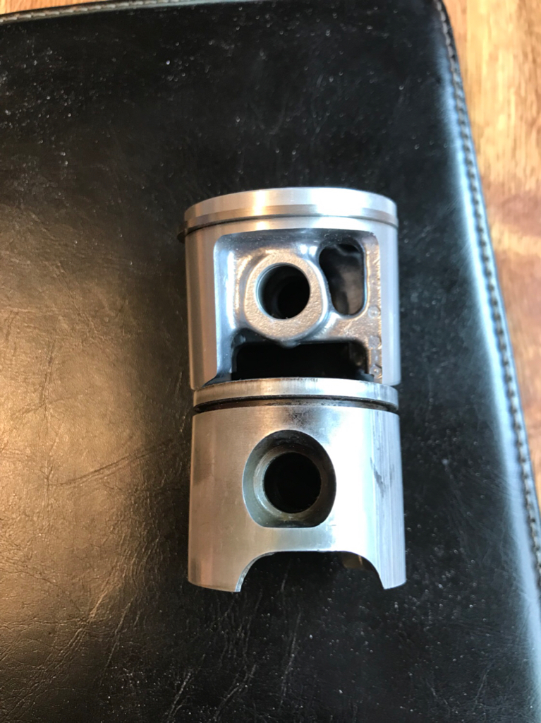

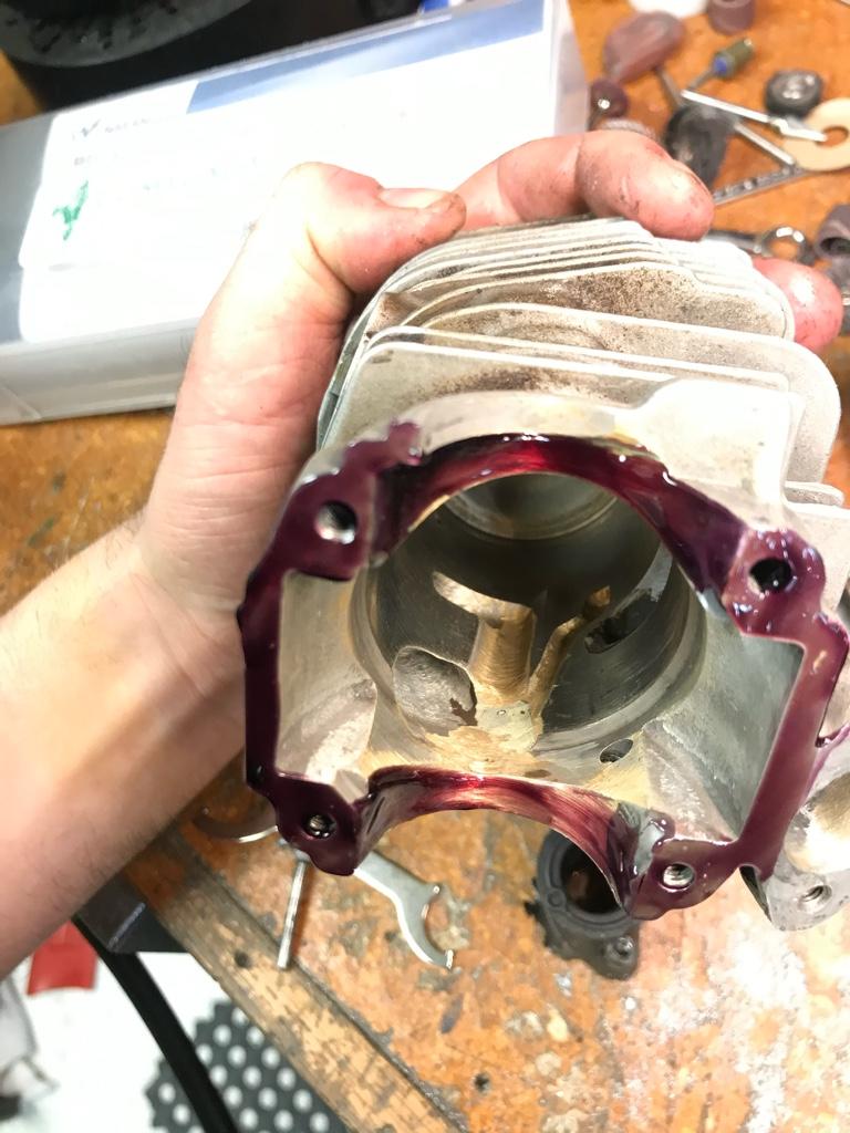

Sent the piston off for some welding. I have started massaging the transfers, the uppers and lowers will open up like the 38cc version but not going to change the timing much. The transfer tract has been enlarged as much as I am willing to go right now... still the transfers are/feel smaller than the 38cc cylinder.
About time for the intake and exhaust. Probably spend very little time on the intake at the cylinder. The exhaust port is actually surprisingly square already.

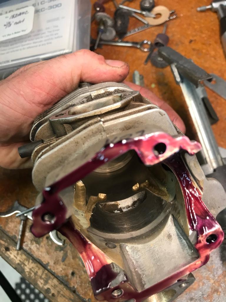

Alright, here is another update.... finally.
Got time to throw stuff together and run several tanks through it this weekend. With the 7 tooth sprocket it cuts much better than the 6. It still has plenty of torque. I decided to file the chain more aggressively (more angle and lower depth gauges) and have found the sweet spot for the current setup.
I may mess around with different chains. .325 would have more teeth and maybe bite more then the lp? I feel like the transfers and exhaust would still benefit from being raised more. No timing numbers as most of my work was very mild and the cylinder was not lowered. Pictures were not finished product but I am not a pro so here it goes.
I doubled the size of the upper transfers (width) and reshaped the lowers with jb weld. Between the transfers and the shape of the complete air path through the saw, compact took the place of performance in the design.
Might mess with it more in the future, but not this summer. She runs great and summer up here is extremely busy...

Thought that I would update this a little more. I went back in and worked over the transfers some more. I also bored out the carb, set the squish and did a better muffler mod with a pipe that protrudes out on the plastic. Not sure if I mentioned the popup piston, but got one of those done up as well. Gauge says the compression is at 230psi.
Here is the important part. Raced my t540xp this summer and it was dead even. Then I realized the 2139t chain had been in the dirt vs a new chain on the 540.
Always check your chain…..
Not even close sharp. Anyways, have a lovely evening
I should clarify, I cut a good deal of that wood with my 2149…..
