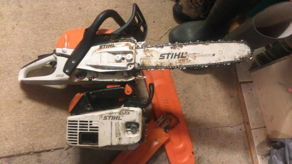

They are both in decent condition the MS261 is a 2017 model with just wood dust on it.. there are no scratches. The 200T is tidy. They both have a spark and compression. But they were both sold as untested. Haven't investigated further. Any gremlins with either of these too look for considering they don't look abused.. any advice would be great. Cheers guys.
Well try to start them up and see what you got. A compression reading would help a bit also .
