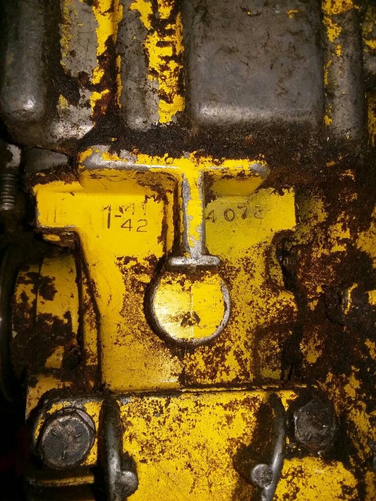

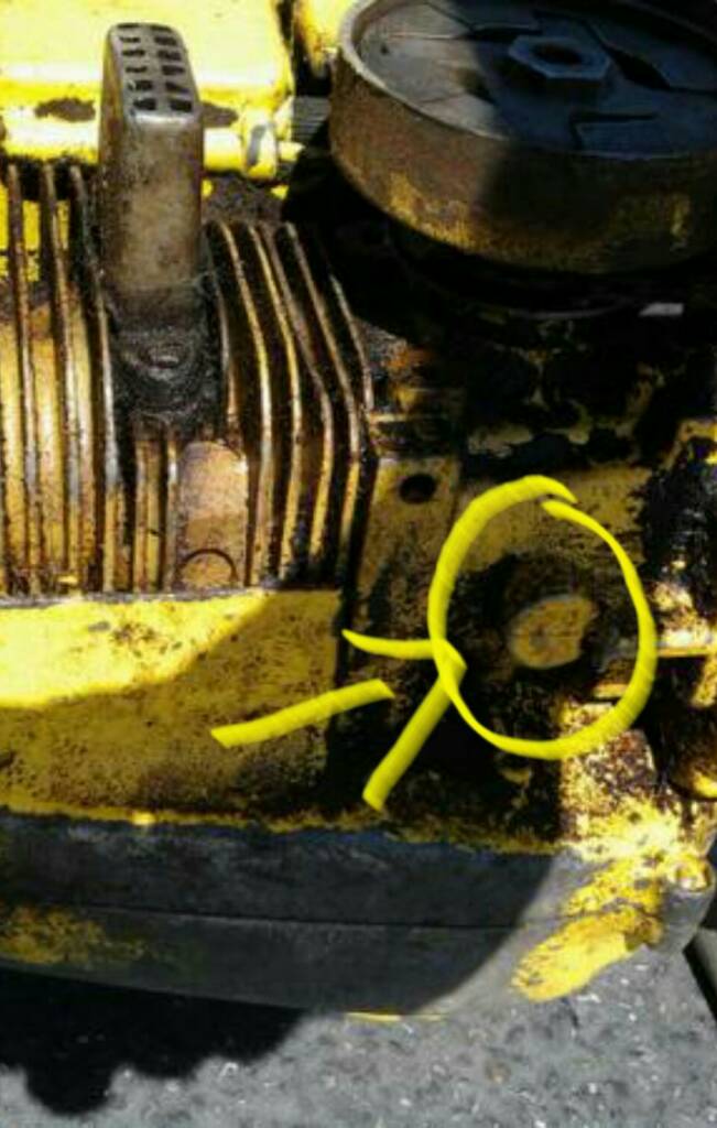

ohadinrehtron
What is stamped here?? Buckin' Billy Ray Smith on youtube mentioned they stamped the model there on alot of old macs.

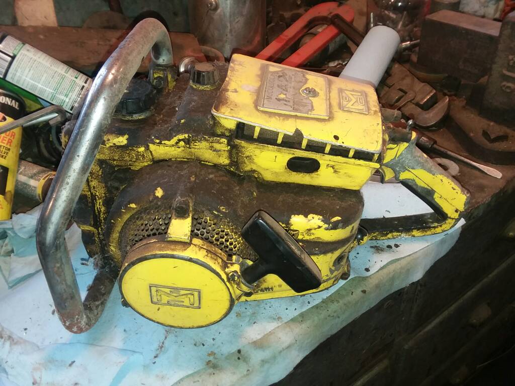

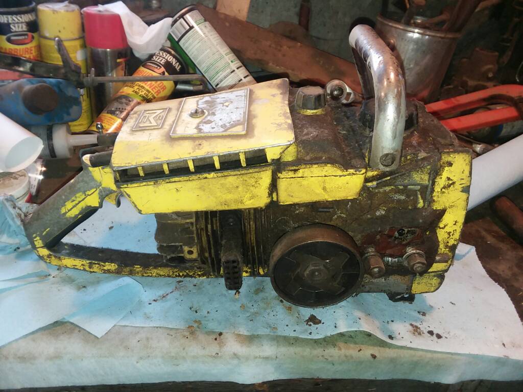

ohadinrehtron
Here is a 1-42. Well used and filthy. Been on the shop floor for over 30 years. Got it to run for about 5 seconds about 5 years ago. Spins freely, super low compression. Have no idea where the clutch/bar cover is. Ran .404 chain.
