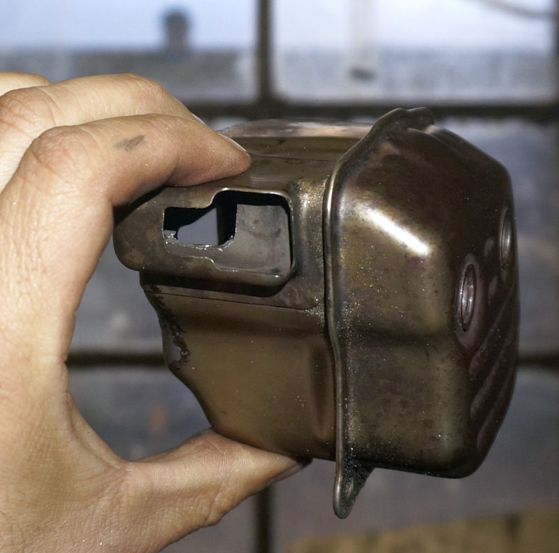

This is the work I usually do on a 261 exhaust:
The results:

I opened up the factory outlet about as much as I could but haven't tried it out yet. One thing that's wierd is it doesn't seem any louder. Looks to be some sort of baffle maybe in the top by the outlet but I don't see a way to get in there any do anything about it
If it has a baffle on the top like the 261 does, you have to get in there with an extended bit and grind away to allow the exhaust to exit straight to atmo. Stihl does make multiple versions of mufflers as evidenced by the fact my image above has no screw hole to mount a spark screen, whereas Willard's does. It's worth it unless you don't like noise. I was always unimpressed when I saw folks MM the 241 and 261 and get like a 10% difference. When you remove the baffle on the 261, it becomes an entirely different saw.
