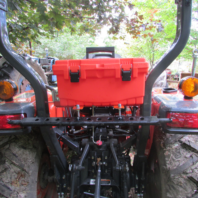

The pencil box from the factory they called a tool box was a joke, Maybe a scrench would have fit in it. I removed that and the SMV sign made some brackets and installed a real tool box. I think even the color mates well. Right now there are 2 wood splitting wedges, two 15 inch crescent wrenches, a 1/2 breaker bar, 1/2 inch ratchet and assorted sockets, a small pipe wrench, about 6 pair of class II 3 point shims I made, a ball of string, and a soup can of screws left over from working on a deer blind. I also like the hooks I added to the over sized brackets. I hang Lynch pins and even the third link pin on them, is also a handy place to hand the draw bar temporary.

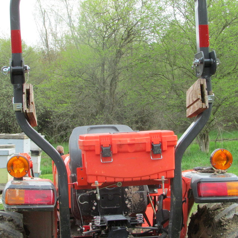

The saw holders are very handy and made with some scrap T1 11 I had. I really should remove them and paint or stain them.
I now carry four saws to the woods with me and I can still use the bucket because chains saws are not in it.

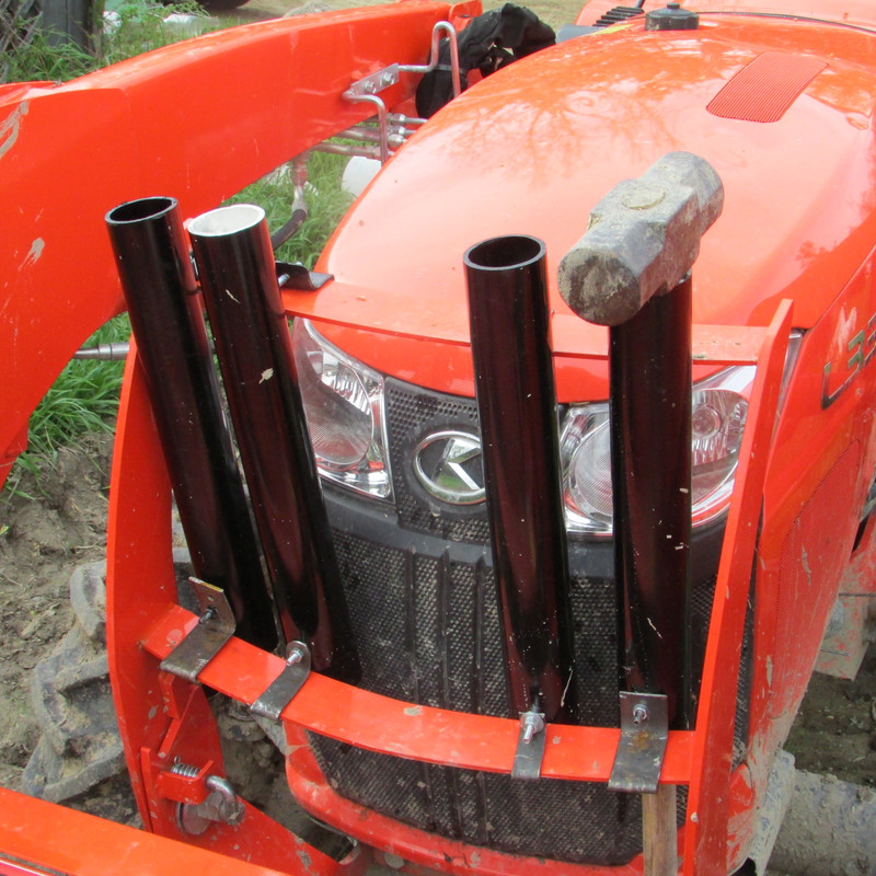

I had a bunch of PCV pipe I picked up from a road side trash pile some pieces were over 8 feet long.
To start I cut one piece and made it as a trial, looked like it would work so I cut another piece drilled the bolt holes in both painted them and hot glued the bolts in them. Got them mounted and thought this is going to be nice , can carry the sledge, the 8 pound splitting maul, my home built timber jack, and my 6 pound splitting maul when I go to the woods. I ran out of the steel for the brackets so I cut down some wider stuff to make the last 4. A couple I still need to finish the paint on the holding brackets still but I mounted them to try out. I think 2 more will fit in there but I am not sure what I would carry at this point.

Looks good Al.
I like the fishing rod holders for when the work is done ;).
What about the lights though, looks like the pvc will block them.
Mine are burnt out right now which isn't a big deal in the simmer, but I need to get something on there for this fall/winter.

Looks good Al.
Theres a spot right there in the middle of the rod holders that's empty. Perfect for a single light.......

I was just looking at the small led light bars at TSC, but I've heard some guys say they had problems with them flickering.
On FHC theres a guy who I should get some advice from, looks like the middle of the day in some of his pictures and vids.
The other thing I considered is making it mount higher than the lights are now, when you have a load sometimes you can't see anything if the bucket is raised much.
Mount it on the bottom of the rops.
Unless you're one of those who fold the rops down

I am going to get around and mount the Led lights un the bottom of the ROP's br and a pair of back up work lights for the rear also. Just takes time to get it done.
Way I have seen it is the lights are useless once the bucket gets raised 18 inches or so.

Thats the problem I've had too, you either have to have the bucket real low or higher than would be safe to travel with a heavy load. I figure since my lights are already out its a great time to upgrade as well.
