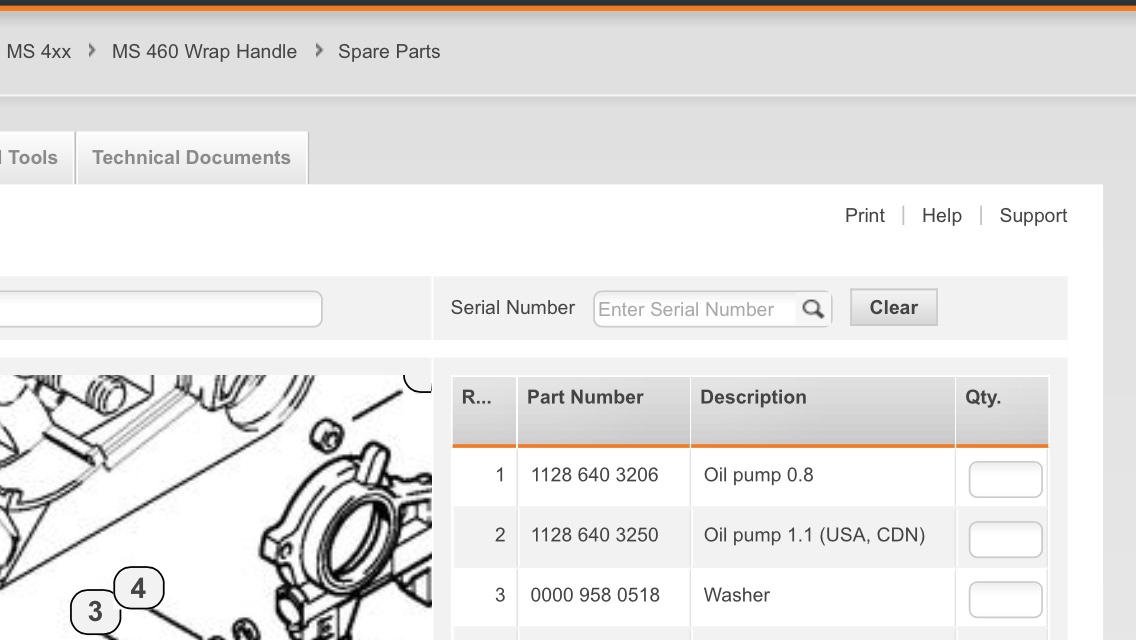

Not sure I would run a 32" very long. I ran one for about 10 minutes and it showed signs of not enough oil. This was in a big dead red oak. I have a 395 now, so I will stick with it for big bar stuff! I don't know why Randy didn't mention this oiler mod when he had my saw. I would of had him do it then. I may attempt it on mine, but I am a little skeered to start hacking a newish saw.
I think you could buy the parts for your saws from the dealer. I found it looking to pick up the oiling on my ms390

I run a 25" full comp but am thinking of getting a 32" for felling some of these big oaks that I've got.
Think she'd pull it or would I have to go to a semi chain?
I don't have the R version so I'm somewhat concerned over the oiler output.

Get the parts for the oiler for $40 or buy the whole oiler for $85~

Mdavlee,
I am assuming it would be easier for me to buy the parts than go through with yours and Randy's "grinding" technique to increase output?
Thanks for helping me out here

Mdavlee,
Just take a peek at it. The hardest part for me was not losing the roll pin. Then if you mess it up just buy the new part.

Just take a peek at it. The hardest part for me was not losing the rool pin. Then if you mess it up just buy the new part.
Thanks Dub,
I'll probably take it apart and snap a few pics so I understand exactly what I'm about to cut off. Haha!

Mdavlee,
It's not too hard. Just a little does a lot.

What happened between the 460 and the 461 that made Stihl reduce the bar length rating? My 460 says it's rated for 36". Granted, it sucks at oiling it (have the oil pump apart now fixing that), and I'd want 80 or 90cc's to do it all day long, but...
Was it a, "we changed something so now we're really only comfortable with 32 inches", or, "36 inches was a bad plan, so we'll put down max 32 for this new model"?
I would say oiling issues
