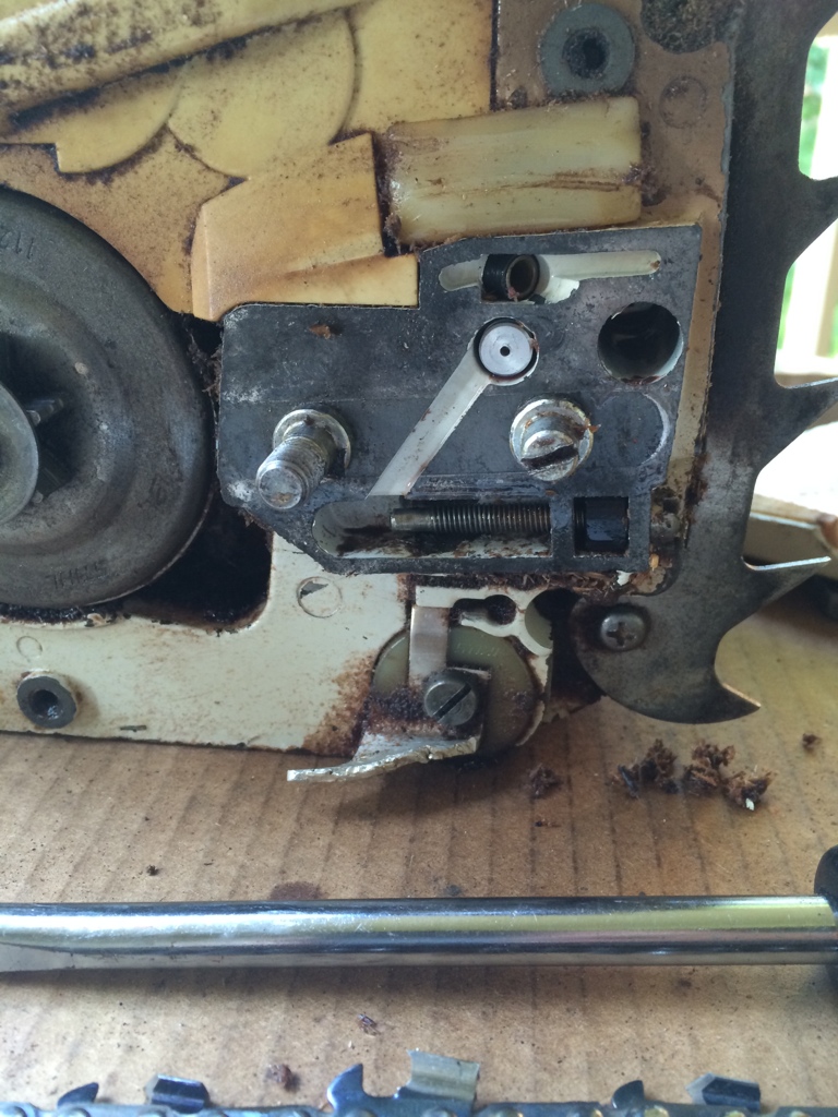

Think I can make something of this without having to put a new case in. Existing bolt holes match clutch cover of a normal 361. Tensioner slot probs needs elongating and squaring off at the ends and a machine screw of some sort needs to be put into the central hole with sealant to stop the oil escaping before pocketing it out to match the current tensioner screw area. Either way I’m gonna try this route just because I like to tinker. If all else fails I’ll just use the case I’ve ordered or if it’s a winner I’ll send the case back.. IMG_5994.JPG

It looks like it would be a lot easier to set it up for a front tensioner, like the early 024 AV.

I've converted my 180's away from the tooless adjuster. Is the 361 made differently? All I had to do was get the normal chain adjuster, and change out the stubby rear bar stud for a full bar stud.

Yes! I never thought of this. So still from the front. What tensioner should I look for? An 038, 024, 026, 044?? I like this idea. And I could just get new studs and a new front plate. Everything else looks like it will be a winner!! I’m excited now! Plus apart from the hassle of tensioning at the front I think they are more robust. Cheers for the thought!

An 028/038 tensioner just lays down in the slot. Nothing holds it in.
