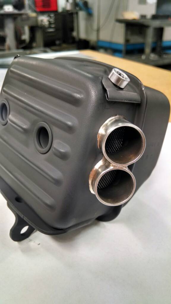

You can do a Lakeside style mod using the TS400 screen and clip, part numbers 4223 141 9000 and 4223 141 6600. You will need to braze in a pipe with 9/16" ID, the screen slides down into it and the clip holds it in.
I like to use the Husky 288XP deflector and screen, I know the deflector is 503078301, can't remember the screen.
503 40 56-01 is the screen

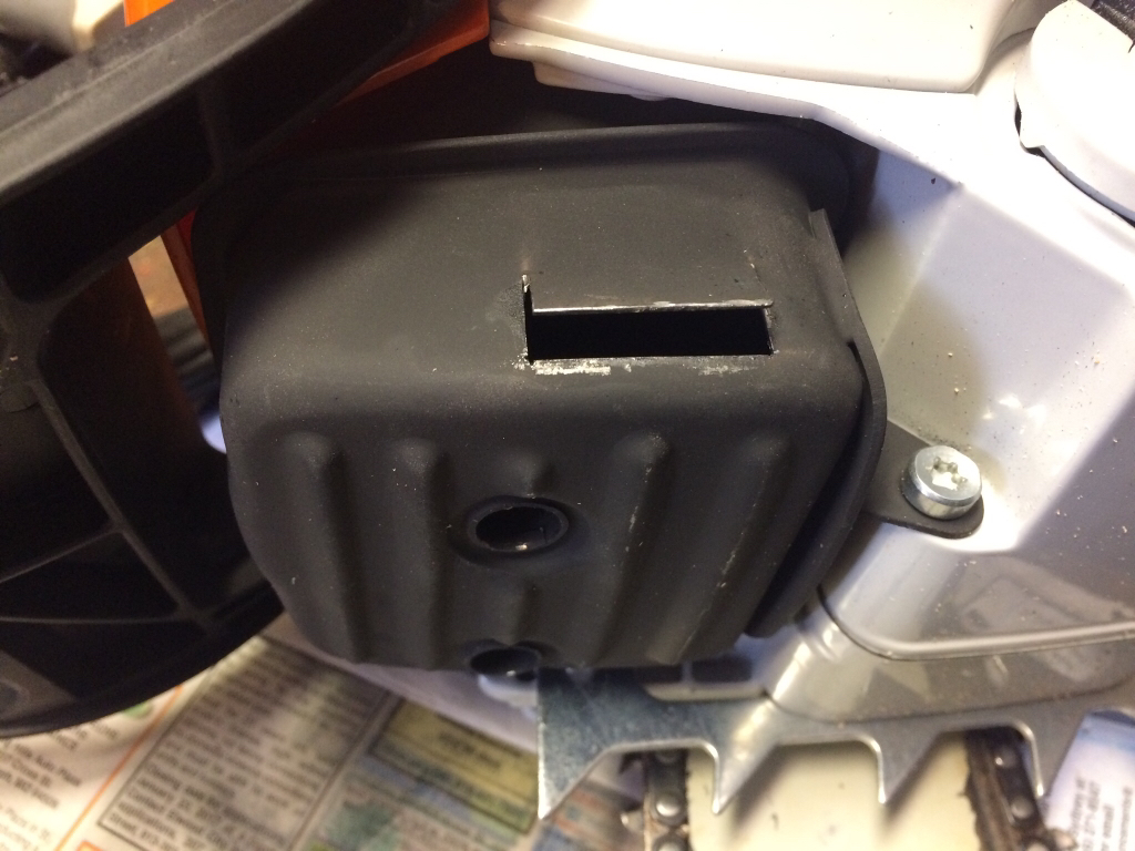

Does anyone have any pics or better description of the old lakeside muffler? It was lost in the great AS crash of 2014.
67L36Driver
2:41 AM
596
9,400
39,362
Ten minutes with a Dremel & cutoff disc.
Farmertec muffler by the way.

Mike does amazing work on muffler mods.
Agreed. He could probably set up a business and sell these for over $100 apiece and never be able to make them fast enough. One has to wonder why somebody isn't already doing it. I once saw a muff modified 361 out cut a brand new 362 at a GTG.
