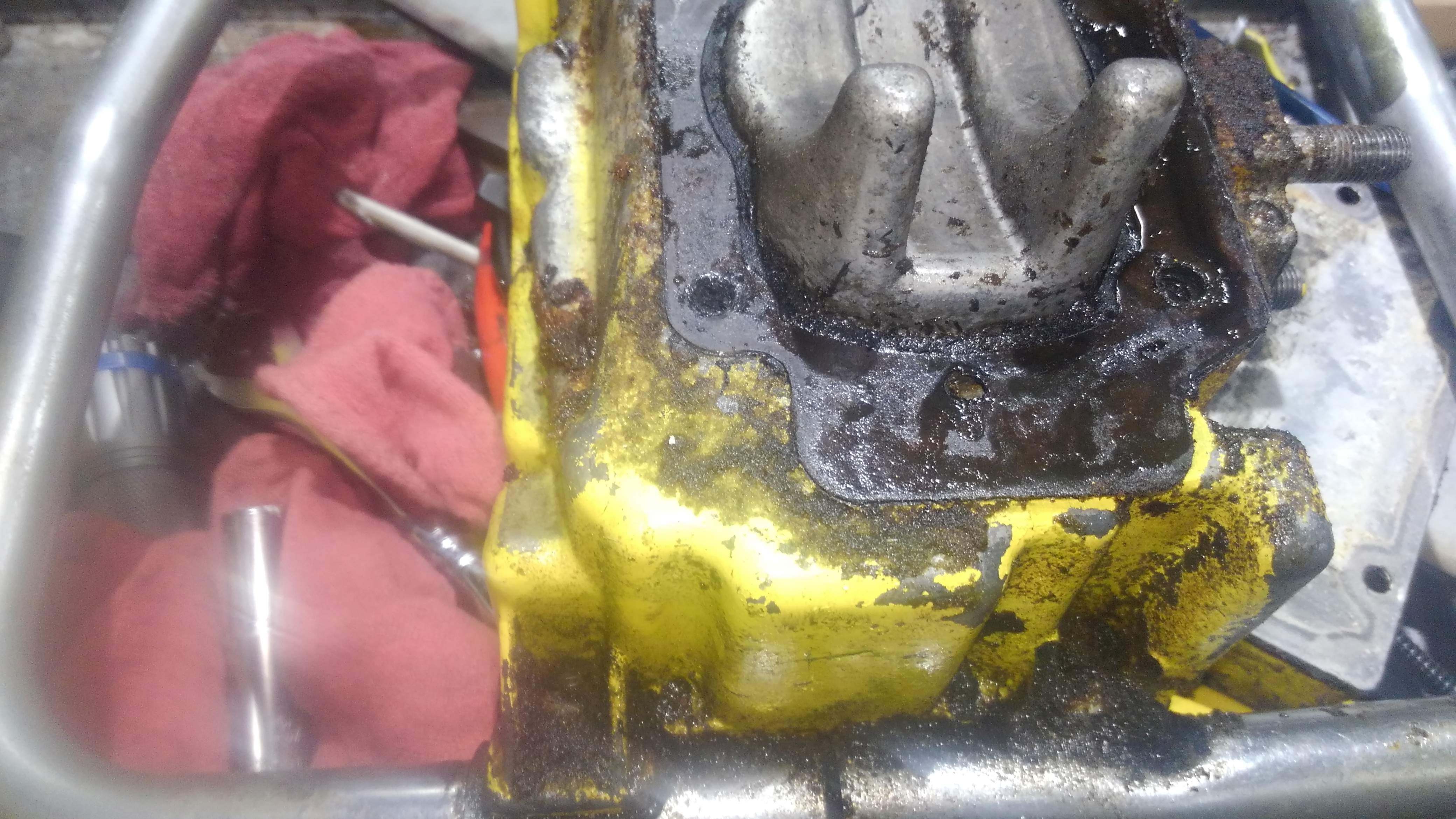

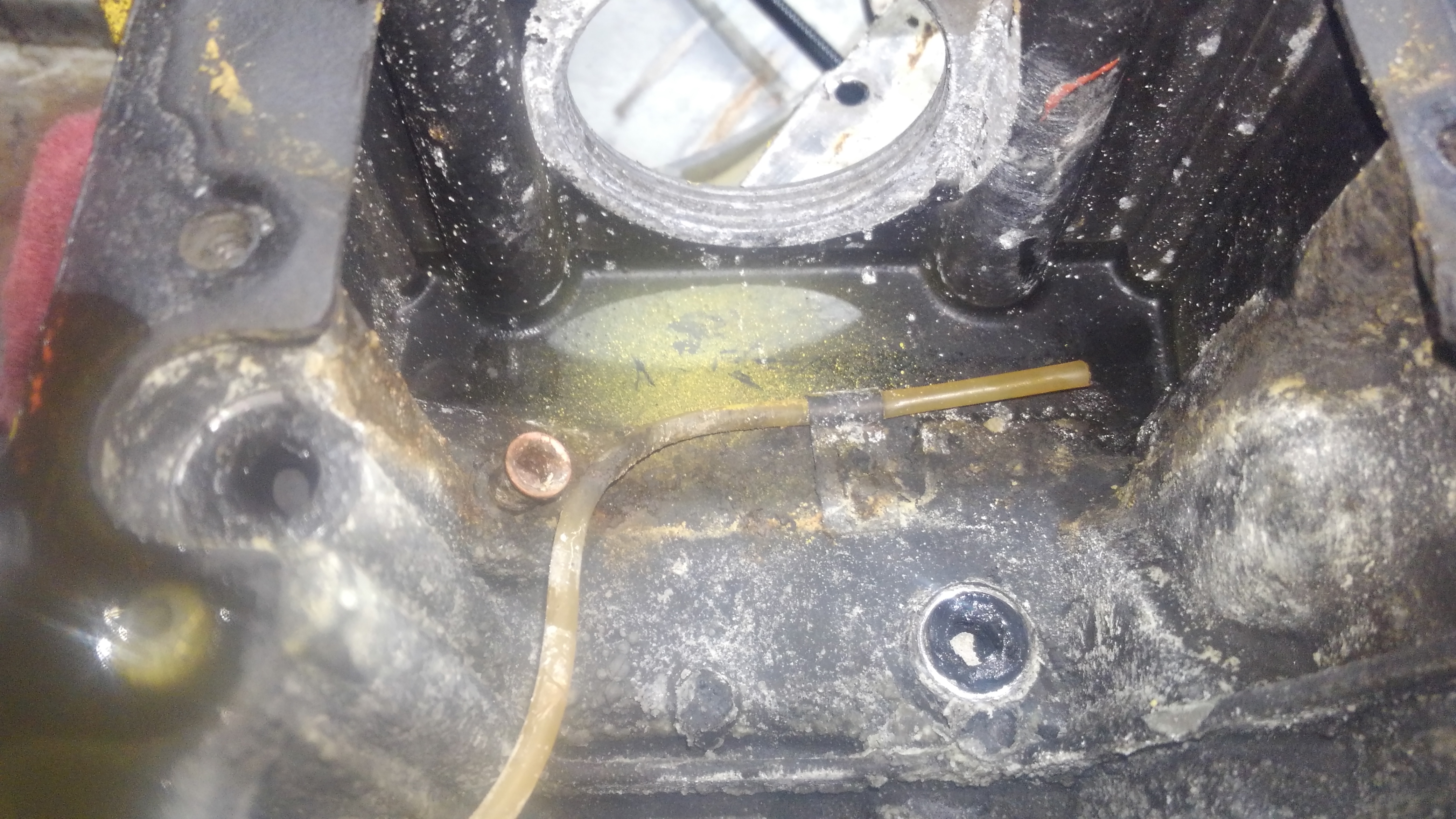

Just got my new to me McCulloch 1-50 running last night and it's got a pretty hellacious fuel leak from the tank. It did have a leak from the tank vent however I found that it doesn't have a duckbill valve on the vent line so putting one on should solve that leak. The second seemed to be from between the tank and crankcase however I pulled the tank off earlier and didn't see any obvious leak spots. I will be bead blasting the inside of the tank after work tomorrow to see if there's any corrosion holes.
