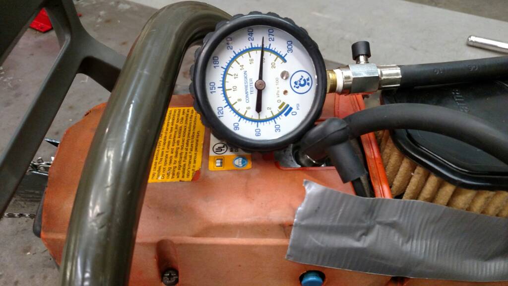

Mine would probably get close to 250 but I can't keep a starter together long enough to get there. How did you do it?

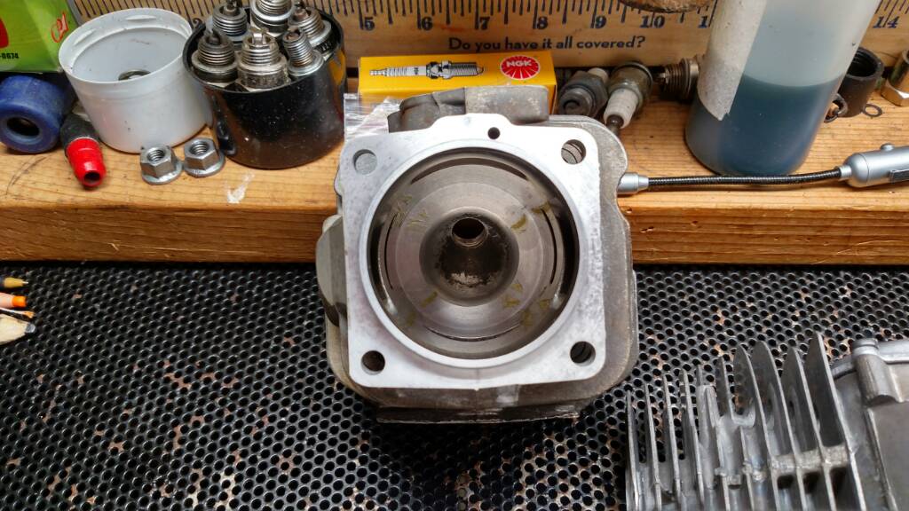

You converting to the 395 cylinder Deets?? Or did you score an OEM 394 cylinder?
Edit: Wait a sec, that IS a 394 cylinder isn't it!!! Either you did a stellar job cleaning it, or you scored!
Both.... I put it in the bead blaster to clean. But the jug is flawless, it's one of the nicest bores I've seen on a used cylinder

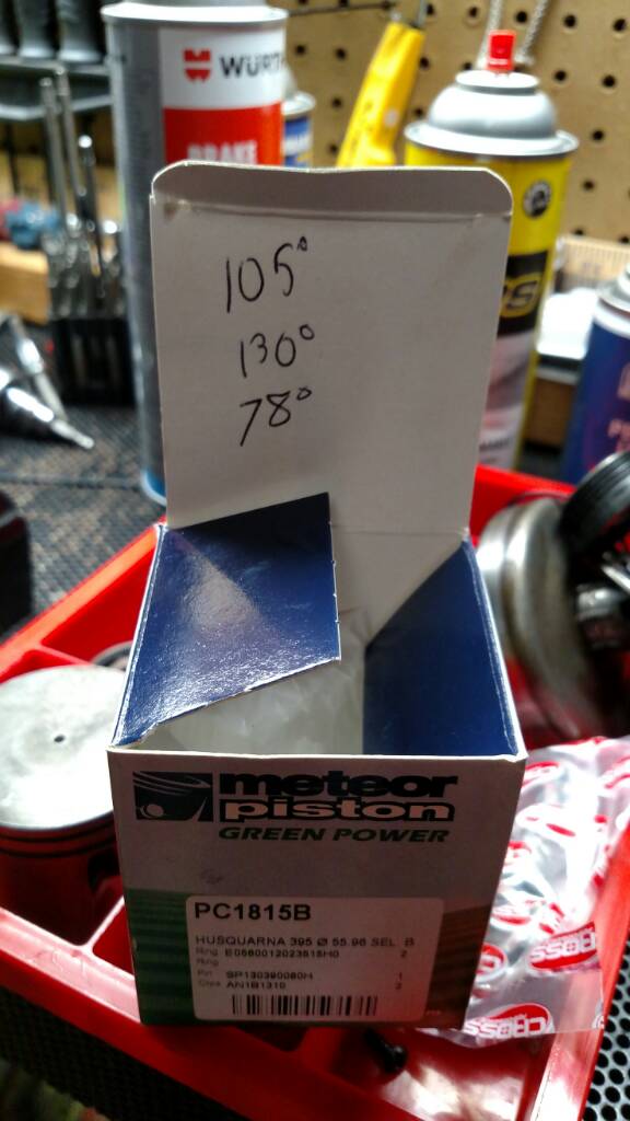

A 394 is the same design as a stihl,basically identical to a 660 for instance only with much better timing numbers.
I take 050 from the chamber and use
103 120 78 and usually 230 or 240 lbs of compression.
You don't have to take that much from the chamber but these big huskys love compression.
I run a little more ex timing (101) than that but the trans and intake are the same. I only take 0.030" - 0.040" out of the squish which drops it around 205-215 lbs compression.
I've made some really great 066's before that will run close to a 394. The key is getting the ex timing down as far as you can.
