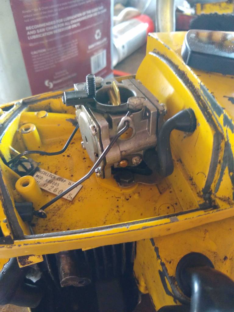

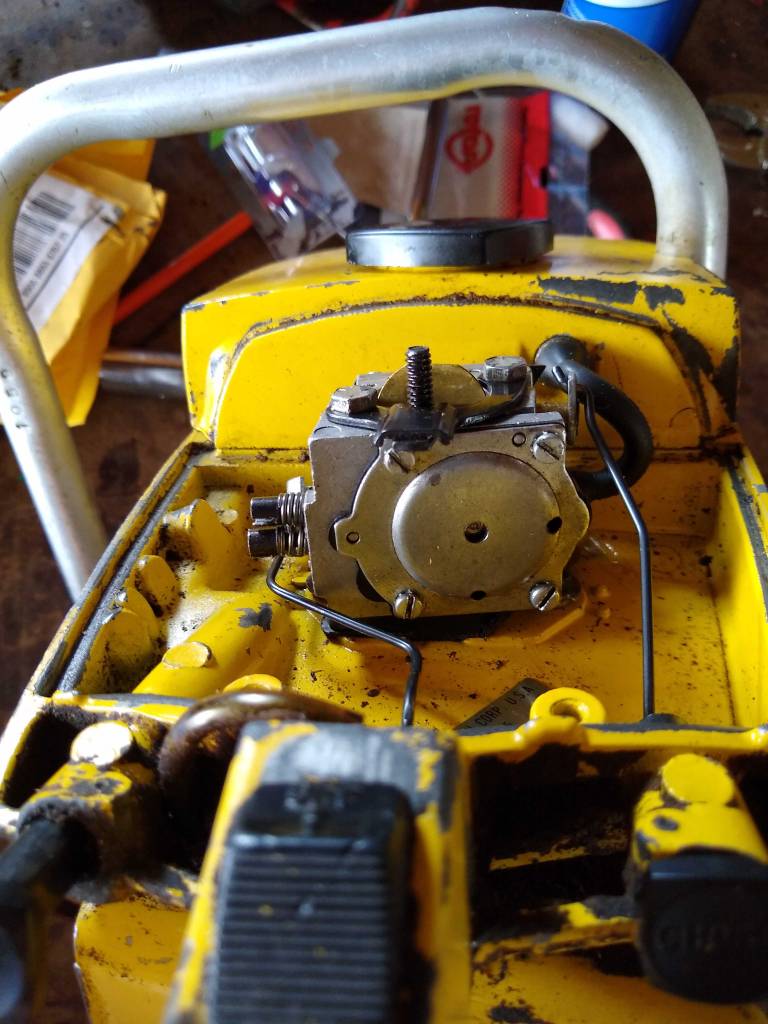

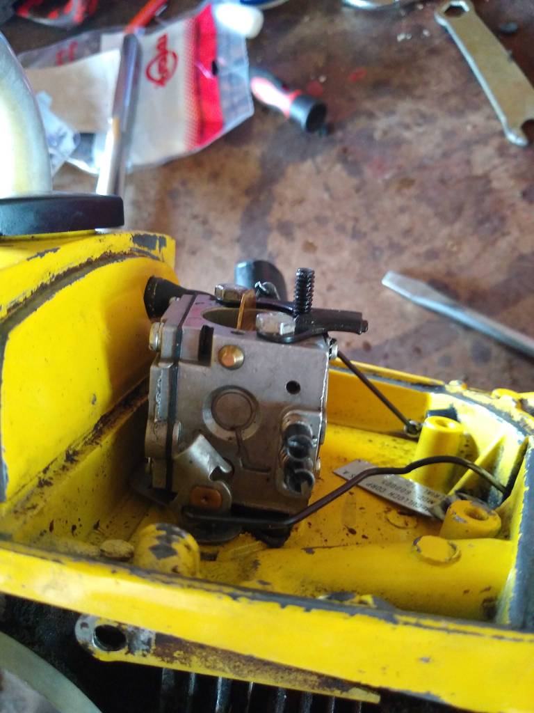

It has high and low. Nothing on trigger. Here are some pics of it. I thought maybe the isle screw was gone but I don't see a hole that is labeled with an i or anything.

Ah ....
Looking to me like that carb is not original to the saw.
None of the bosses in the side of the carb box have been drilled/tapped ... that carb looks to have been equipped for just that.

Ok, that could make sense. I got 2 10-10's together and neither would run. The other saw is older and had a trigger idle screw. I bet someone tried swapping them. The other one had a walbro sdc with an idle. I'm going to switch them and try again. Thanks!

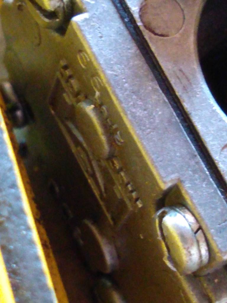

If I get a chance I'll try to determine age from the number plate shown in one pic .Quite frankly I'm not certain exactly how the idle was set on that model because many methods were used .Just the IPL's on the 10-10's are many .Remember this model covered something like a span of 25 years or so of production run . Mark H could probably tell the info from memory but I'll have to glean the IPL's myself . I might have a right hand start in the shed buried in that mess of chainsaws ,weed wackers,blowers ,small engines and other assorted treasures.

So far from an IPL dated June 1970 this model of 10-10 used a variation of a model SDC-1 Walbro which most likely was rebadged with a McCulloch logo .From that IPL it used an idle screw attached to the carb .
I wasn't able to get specific the exact manufacturing date .
It was not and still is not unusual for chainsaw makers to have the carb builder make models with their brand embossed .I've got some with McCulloch and some with Stihl .
