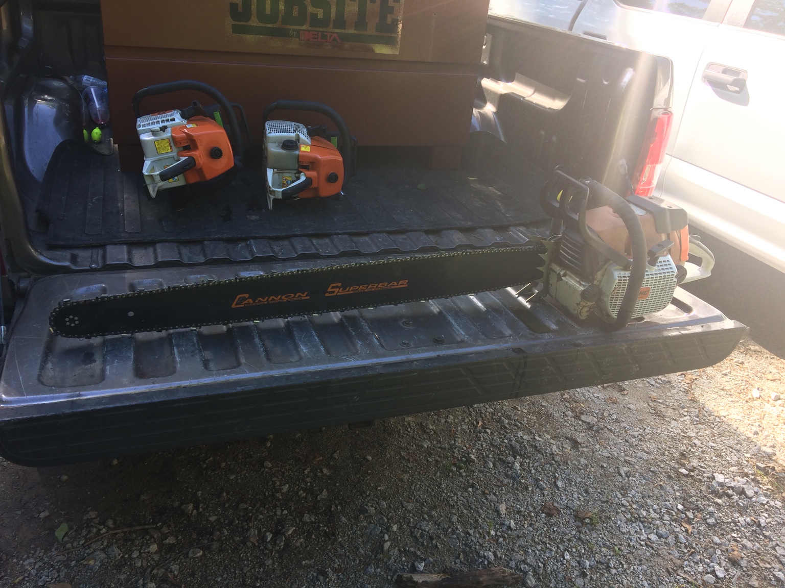

I'm agreeing with @Redfin and arguing wif uncle @hseII. 395 puts out twice the oil for longer bars:argue::campeon2:
My 41" is pretty slobberingly wet on that 066: The Sushi Hara 36" Bara on my 660 is just right also.
I don't disagree that the Huskys put out more than the Stihls, but a lot of the issues I've found were related to too small a bar hole with the 1122 & 1128.
Typically, my oil tank runneth out when my Fuel tank hath no More, on both saws: I think that's perfect.
The only 394/5 I ever had wouldn't hold Oil over night, so maybe they put out Too Much?
