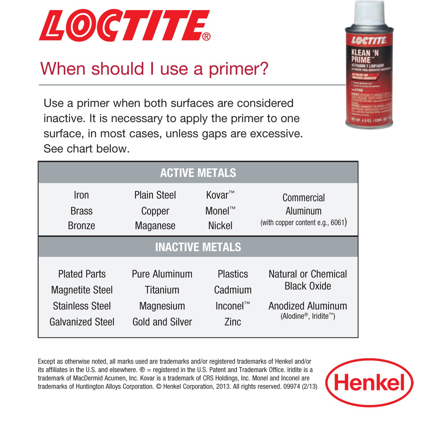

I found this image on an amazon listing for a loctite primer:
So do the jugs have copper in them? If so then the primer is unnecessary.
