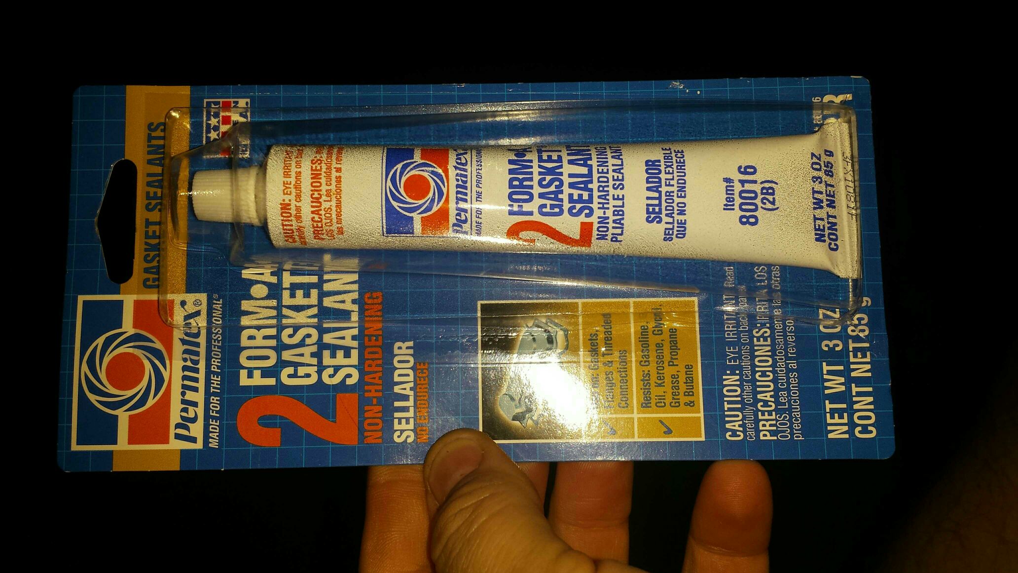

Anyone use that stuff? I usually use Ultra Grey as its available, but found this at the local farm supply store.

I tried that but non hardening means it stays sticky from now on.pretty much like thick Indian head shellac that doesn't dry.

Anyone use that stuff? I usually use Ultra Grey as its available, but found this at the local farm supply store.[/QUO
Have used that many times on Auto engine rebuilds, that sealant seems to stay soft. Try Motoseal or others suggested, when pulling off cylinder after using Motoseal, you will see big difference. Just my 2 cents.
Would there be any drawback for a sealant to stay moist? Does hardening do anything perceivable? Always trying to learn more...
i would imagine that the non hardening stuff could get sucked or blown out over time.
