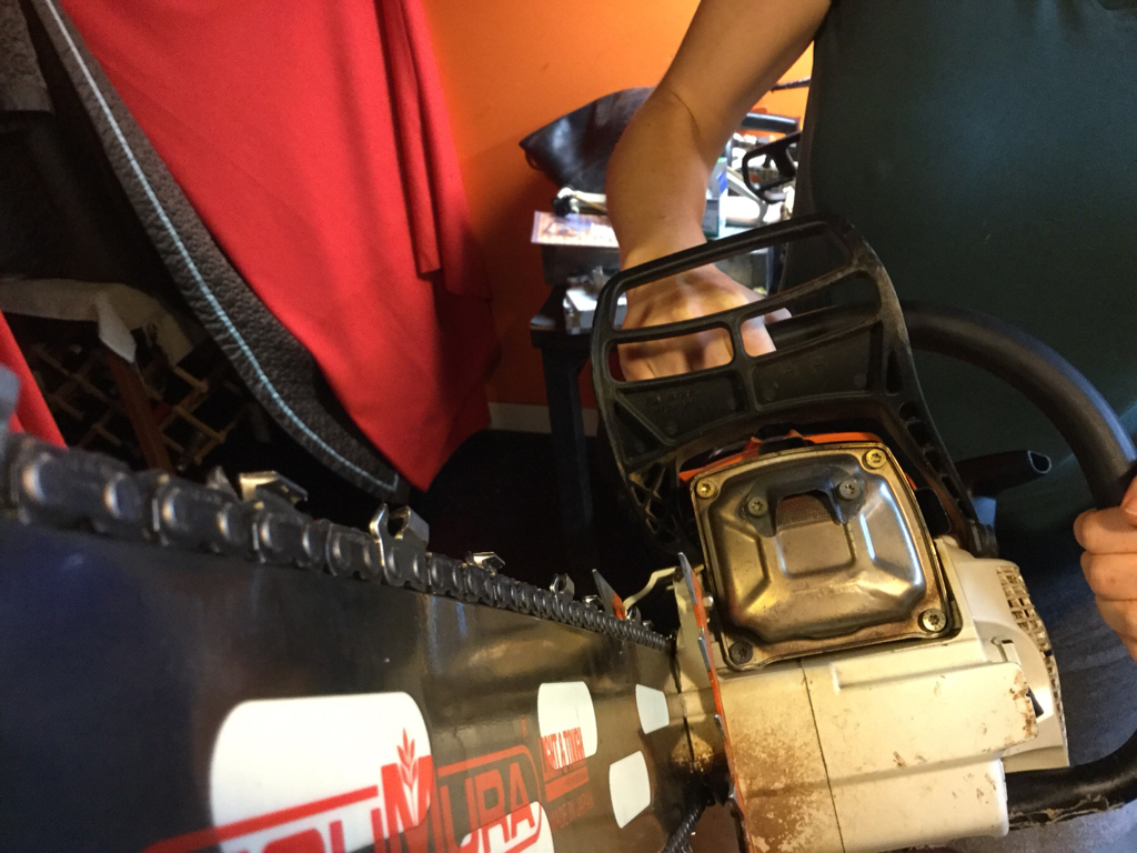

Haven’t run a file over it yet but looking forward to it.
I’ll try to get more glamor shots, but this’ll have to do for now.
Seriously,
Why wouldn’t I run all my saws above 75ccees on 404?
Beasty, holds an edge, less cutters to sharpen.
Where’s the down side?
I know older saws ran bigger chains but what’s the history of 404?
Was it only for loooooong bars?
I know little and would love to know more.

Like anything, pros and cons. It cuts slower for one thing. On most saws anyway. Over 90ccs might be a different story, but under that, 3/8 is probably gonna be faster. Bigger cutter, wider kerf, and bigger sprocket (.404x7pin is about the same as 3/8x8pin) means you need more power to turn .404 than 3/8.
It's also not as smooth as 3/8. More vibration for the user and more stress on the bottom end of a saw. I've never used it for limbing, but I think I can venture a guess that it'd suck.
Probably not a big deal, but local availability is probably just about nonexistent. I doubt many shops carry bars, chains, sprockets, or bar tips in .404. Maybe out west?
