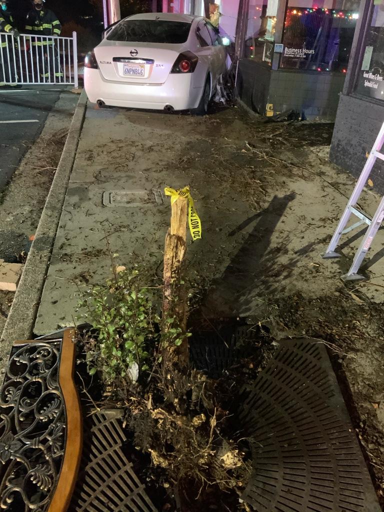

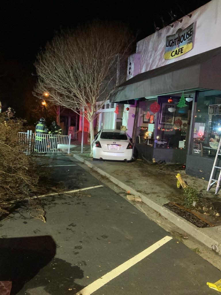

Think they left too much holding wood
Luckily unoccupied Sidewalk dining area

Hate it when that happens. Imagine if you were on that ladder :eek:.

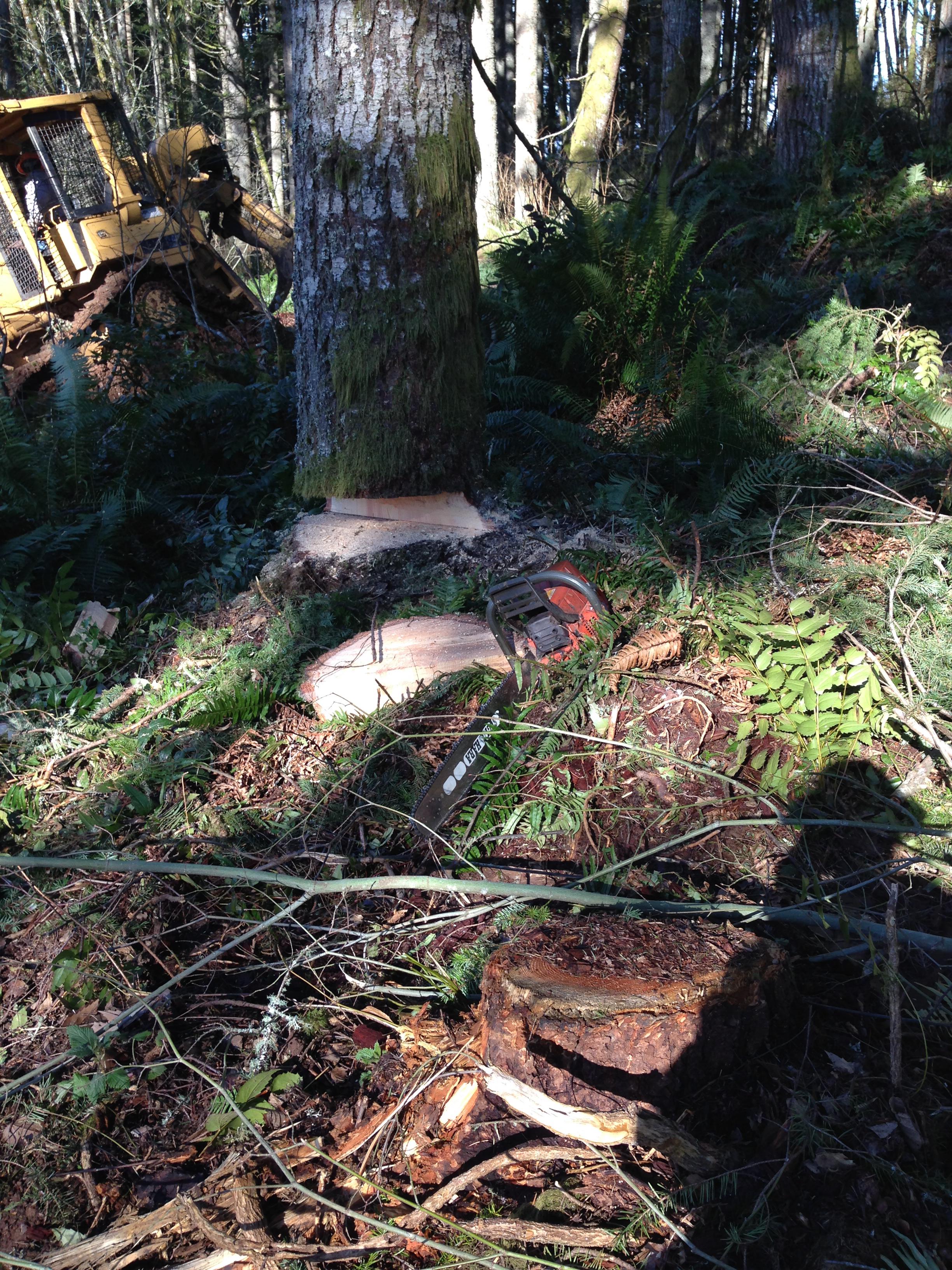

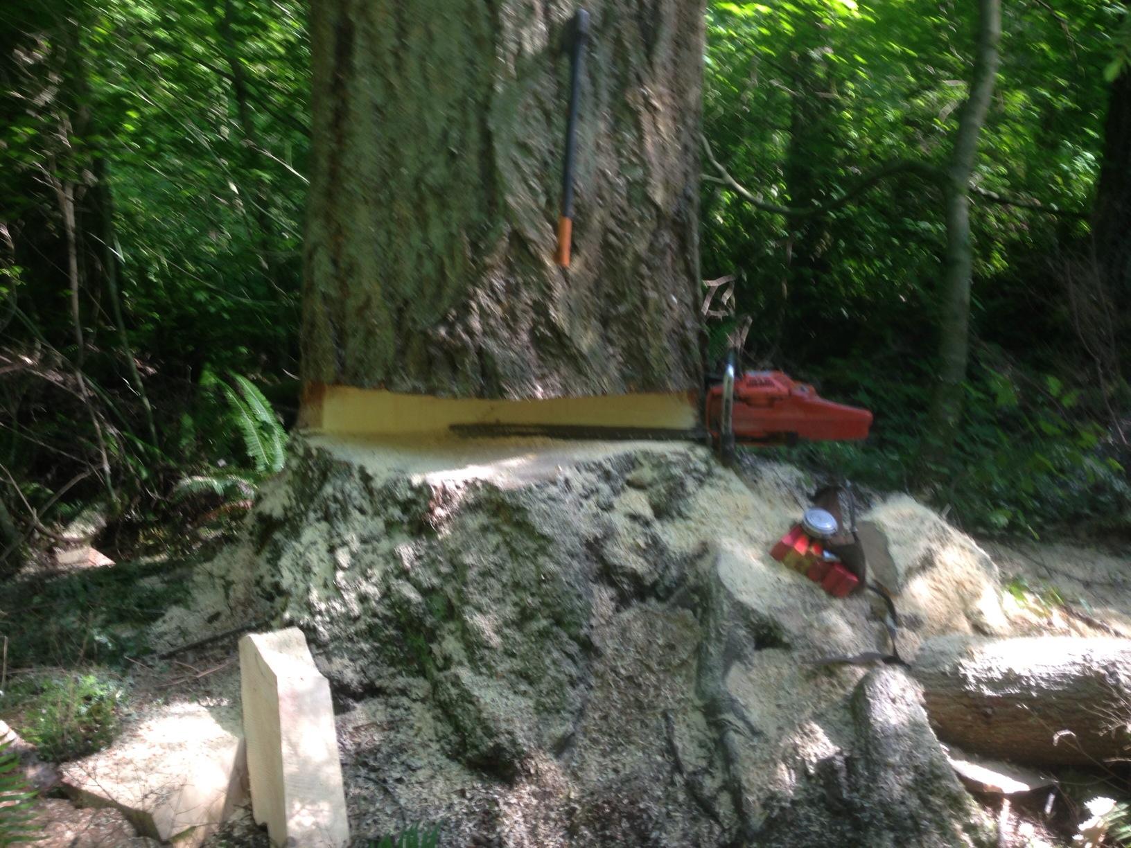

If I wanted something that has maximum time on the stump I’ll normally be looking at a face that looks something like this.
