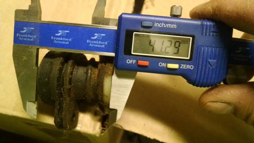

I need any one who has a Husqvarna 372xp or 365 special intake boot laying around to measure the inside diameter of it and tell me what it is. I have a 365 special jug here at home and it has the step on the outside of the intake to hold the boot in place. I'm looking for the inner diameter of the boot that fits this jug.
Ik I sounds crazy, but that's what I need.
Thanks in advance, Austin

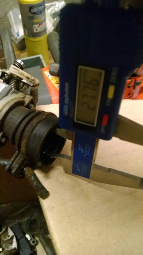

Looks like a cool box, I should also be clear, I need the inside diameter where it bolts to carb, like the actual dimension of the intake throat, not where it clamps on

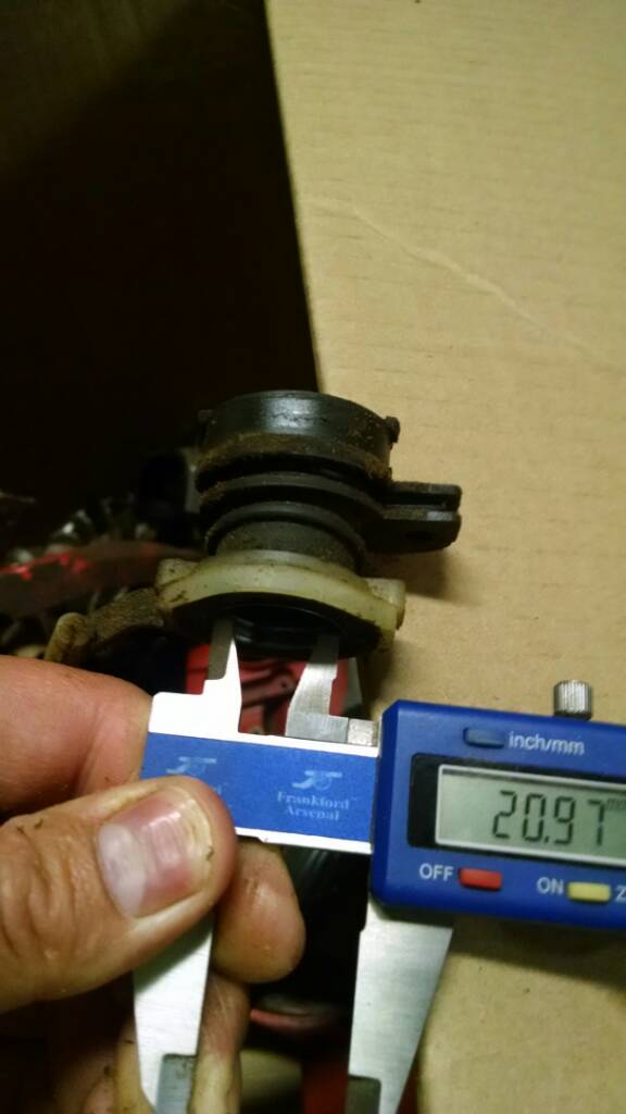

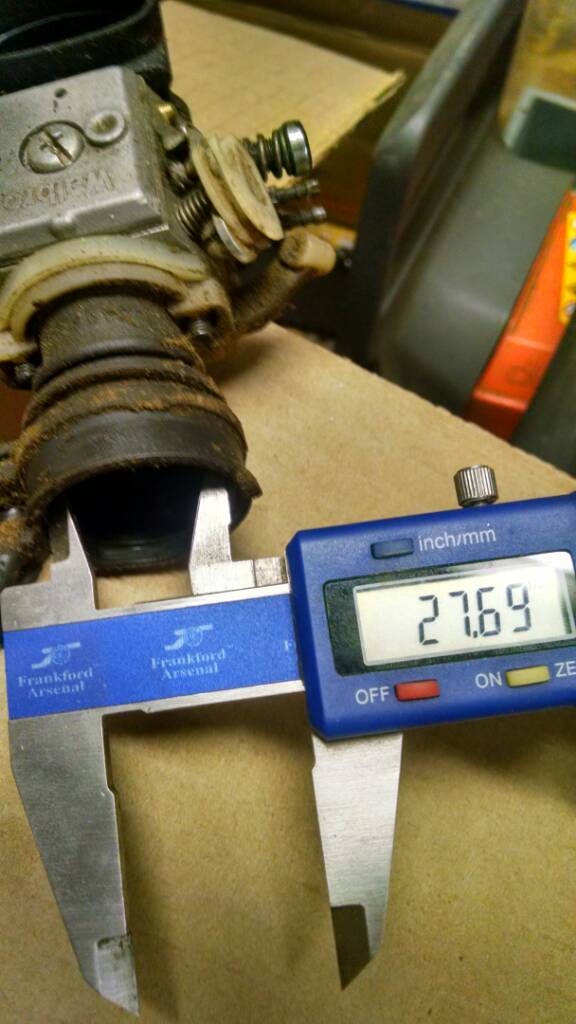

Thank you very much sir!
That's exactly what I needed. Would you want to get an overall length measurement of it? Ik ik I'm being a pain in the a**
