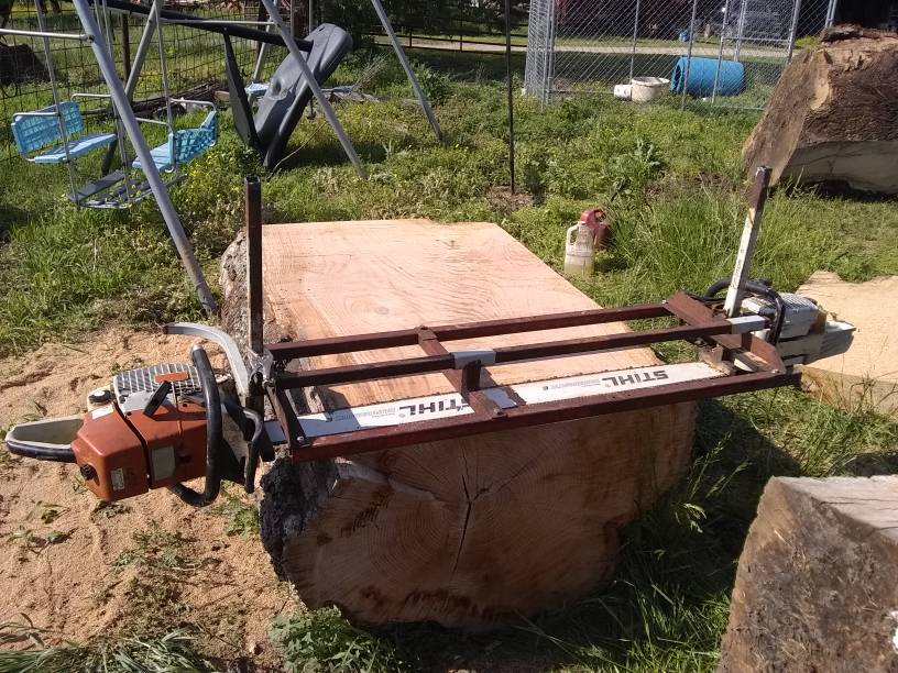

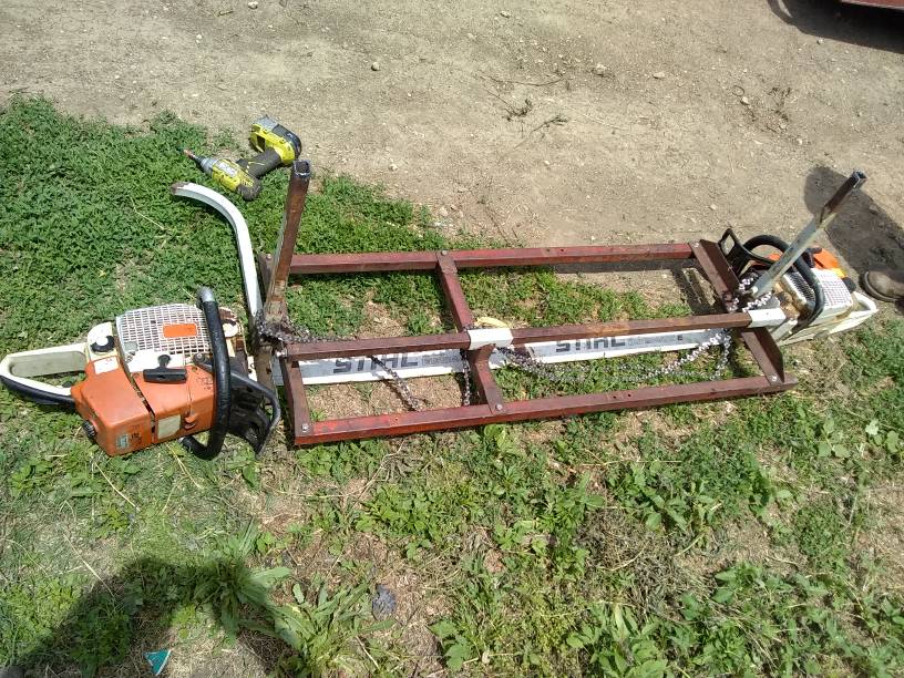

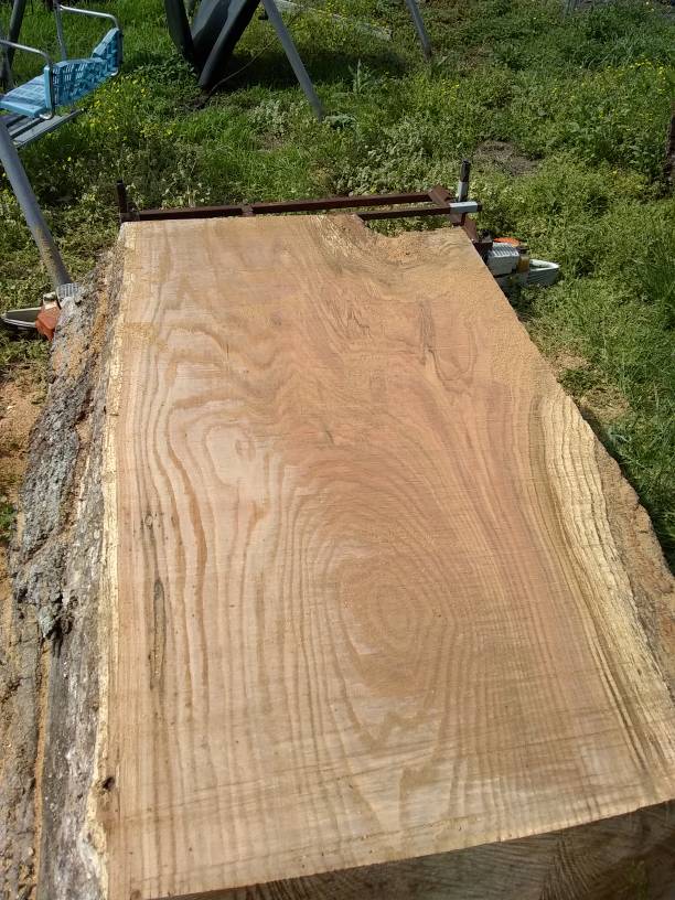

A buddy of mine came across the homade dual bar in a trade deal. I finally got my mill ready to go so it would mount up and made up a loop of chain. Ended up needing 170 drivers... It does make quite a bit of difference having the extras saw on board...they are still thirsty however.....1/2 tank per saw, per cut..5' long 42-46" wide....

Reviving this thread from the dead, can we have pictures of that bar?

460 and a 660?
