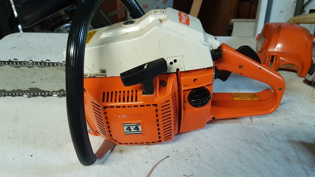

After all that work the coil failed,
Damn that's a clean little saw.

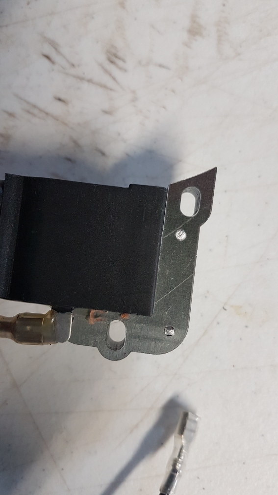

Here's my question, I've been reading that a 55 rancher coil will work on the 44's , but you have to elongate the rear screw area on the coil to get flywheel clearance.
I just ordered a coil off fleabay and going to try it .
Any if y'all heard this???

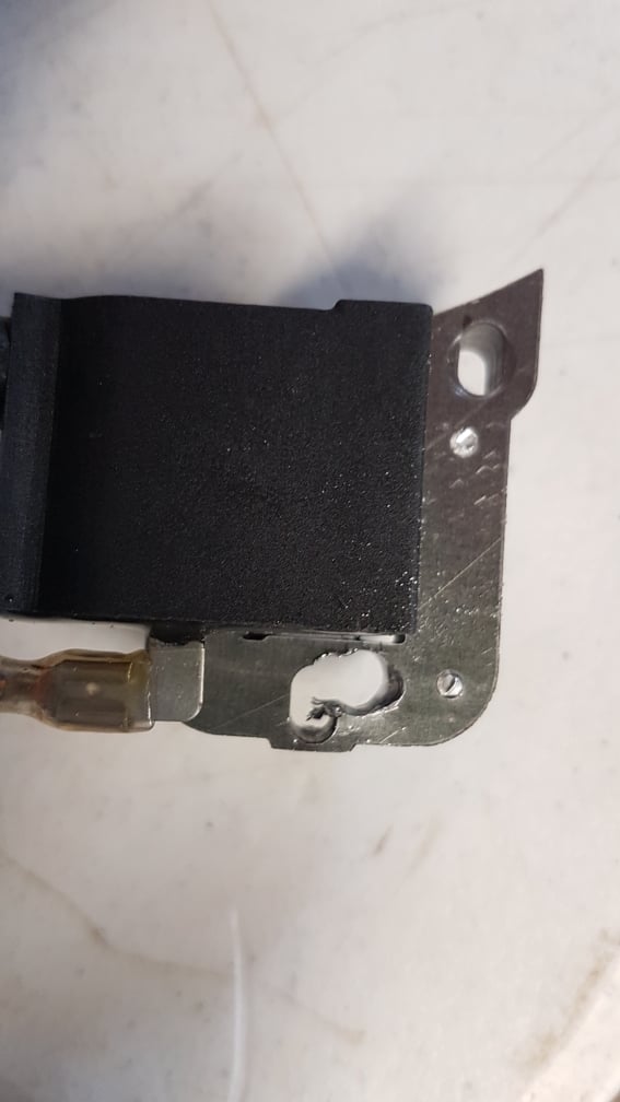

A 55 coil WORKS,
TAKES MODIFICATION
But it works perfectly.

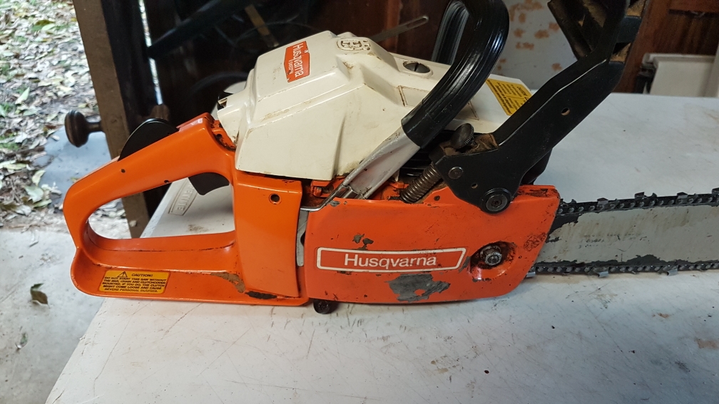

Here's some pics of coil and a clean little saw.
Btw coil was 11 bucks china
