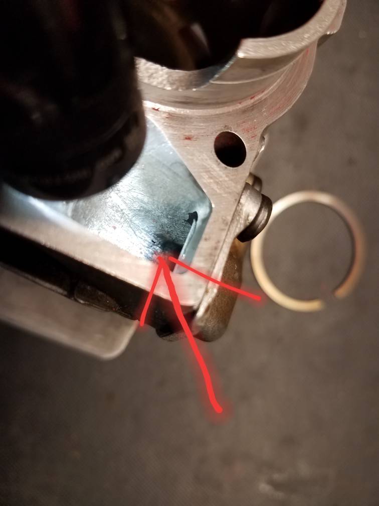

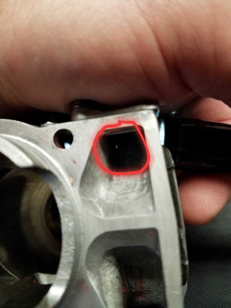

Hello guys.
I had this saw ported a few years ago and it never did run right. I was irritated about the whole deal so I threw it on the shelf and that's were it sat until now.
I pressure/ vac tested the saw and it had a bad leak between the crankcase and cylinder (Dirko was used).
Upon pulling the cylinder and looking it over I seen 2 smears of Dirko in the transfer tunnels covering over small holes that went into the muffler bolt threads.
My question is what would be the best way to fix this? Would this area get to hot for JB Weld to work?
Note- The individual that ported the saw is no longer around the forum and it really doesn't matter who it was.
Thanks for the help.

Here's a few pictures.
I doubt that that area gets very hot at all, especially with all the transfer flow, the JB Weld should be just fine.

You said the saw also had an air leak at the cylinder base. I’m thinking the cylinder extension may be bottoming out in the cases before the cylinder.
It would definitely be worth checking. Perhaps simply installing a base gasket instead of dirko will be enough or you can sand down the cylinder extension some and try dirko again.

I agree with CFB - I've had two ported 562s and one was done by a local guy who didn't know to machine the
cylinder extension. Luckily I caught it before I put the saw into service full time (it had an air leak that the auto-tune
was compensating for).

Can you get to the holes on the outside of the cylinder?
No, just from the transfer port.
Thanks for the heads up. I just went out and checked and cylinder extension has not made any marks in the case halves and everywhere I measure it clears by about .5mm.
While out there looking it over closer I noticed the 2 bottom transfer cover screws where hitting the case so I filed those till they didn't touch.
As of now I'm thinking between the transfer screws hitting the case and a poor prep job for the Dirko application is why it had a massive air leak. (While pressure testing I could pump my Mityvac 8500 as fast as I could and I couldn't build more that 5 PSI)

Should be more than a few threads on porting the 562 if I remember correctly.
I still haven’t done one, but I do recall reading that areas on the case need to be relieved, even to drop it a gaskets thickness. I don’t recall which areas. In addition, I’ve been told it’s one saw where a case gasket is a must, unlike others.
I’d say JB would work great, just put lightly oiled ex bolts in the holes before hand or use a thread cleaner afterwards.

2 areas... in the front left and right need to be relieved for clearance. Also, make sure you oval the lower muffler bolt holes. If not, when you tighten the muff bolts, it will lift up on front of the cylinder causing a leak.
The mitivac going up to 5 psi on vacuum sounds like it might be sucking in the decomp.
If the exhaust bolts reach the areas that were ground through, you could smear more dirko on the bolt threads. Or like you mentioned, a little flat dab of jb would work after you degrease the area. I'd have the bolt installed first if I did this, or clean it up with a tap the next day

I can't remember if it's the 562 or 550, but on one of them an upper transfer cap screw hits the case on the wingding on the clutch side.
Both take a fair amount of clearancing to get the cylinder to sit flat. I normally reuse the gasket on these saws, but I still make sure the cylinder will sit flat without the gasket.
Front PTO side corner usually needs clearance for the transfer cap and screw.
Rear flywheel side usually needs a little massaging to clear a lip on the cylinder.
Flywheel side of case needs a little love to get the intake partition to drop all the way down.
Plastic flange on the cab tray needs a little trimming for the partition.
I painters tape over the crankcase and grind on the case while holding the shop vac to suck up chips as their being made.
Good idea, thanks for the pointer.
I'll check this tonight, thanks.
At the time I only did a pressure test, didn't get to a vac test because It leaked so bad. I plugged the decomp when I pulled the cylinder.
Good idea, I'll check this tonight as well.
I noticed that last night, It clears by about a mm.
These are the area's I haven't checked yet, thanks for pointing that out.
