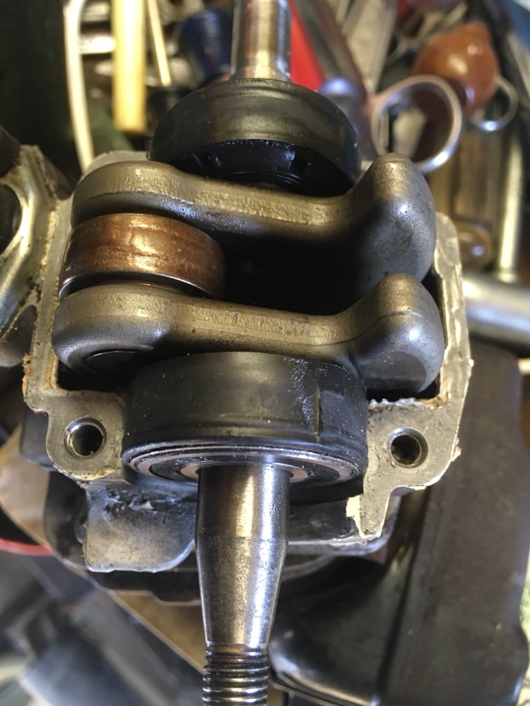

Husky 335xpt, strange crank seal.

Do they share the same bearing/seal arrangement with their rear handle brothers.
Looks like a sealed bearing with a goofy lip seal/cup added on the INSIDE.
How is mix oil going to lube the ball bearing?
WTH!!!

You'll see those on a few Husqvarna clamshell and plastic Poulan saws like the 142 and wild thing.

You need bearings too unless you cut the seal off.

Waiting on seals for a 340(?) that looked about rite. See if they will work.
Husky dealer wants $40/bearing & seal.
Yikes!! [emoji33]

I did have a set of Poulan seals and s 335, but I don't have the seals now :(.
