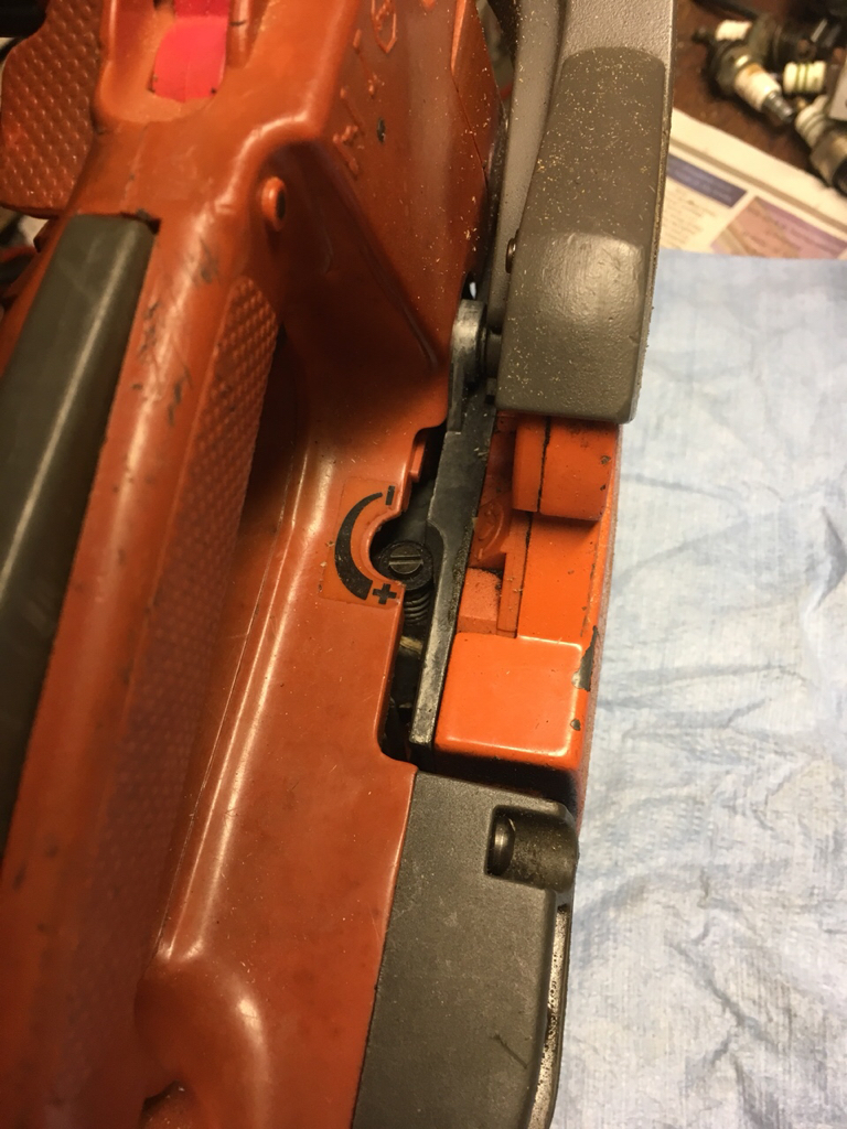

I've got some questions that I dont really have an answer to, so I decided to ask for help and opinions. Got this Husky 335, I've pressure and vacuum tested both the crankcase and fuel line (fuel line and filter are new). Good to go. Lever is set at right height, fresh carb kit. Lower piston skirt is worn, rings look ok, my guage says pulling 130# of compression. It pulls up to 130# after 3 pulls cold. The problem I am having is it takes about 10 pulls to get it to pop. Once it does if I mive it to fast idle I've got to leave it there for about a minute and after that she runs rwal nice. Before that if I click it to idle she stalls. It sounds like an air leak, but where would it be coming from? Could it be a passage way in the carb that when it gets hot and expands lets more fuel flow by? I know I've got to replace the piston on it, and when I have it apart I'll replace the fuel vent. Thanks in advance...

The super weird special crank seals on them are sneaky to leak. $25.50 a side w/bearing (sealed to boot) plus shipping. [emoji90]
Limiters off the carb (also special freakin thing)?
Riches up the low about a half turn.
Burns the back of my hand if I didn’t wear a glove.

Yeah to all of the above. I modified the muffler, opened it up a little under the opening for the muffler. Seemed to do a better job of dispersing the heat. But if it seals up when its hot, why then does it pass a p&v test when its cold? Doesnt make any sense to me... Its not the fuel settings, lord knows I've screwed with them enough to know and why would they get better the hotter the machine got? This ones got me baffled big time..

Yeah, your right it does cut good. Might have to try that. I heard the carbs were finicky, but this one takes the cake. Maybe it is all in the carb?

I agree. But it doesnt cut that bad with a MM. I finally got the carb dialed in, I've never met a carb like that. It now starts on average 6 pulls (regardless of if I let it sit), stays running and if I shut it off starts right up. I'm happy with it but if anything goes south, I'm not so sure that I'll fix it. I've got an engine as a spare, but at $25 a bearing, thats got to be thought out well.
