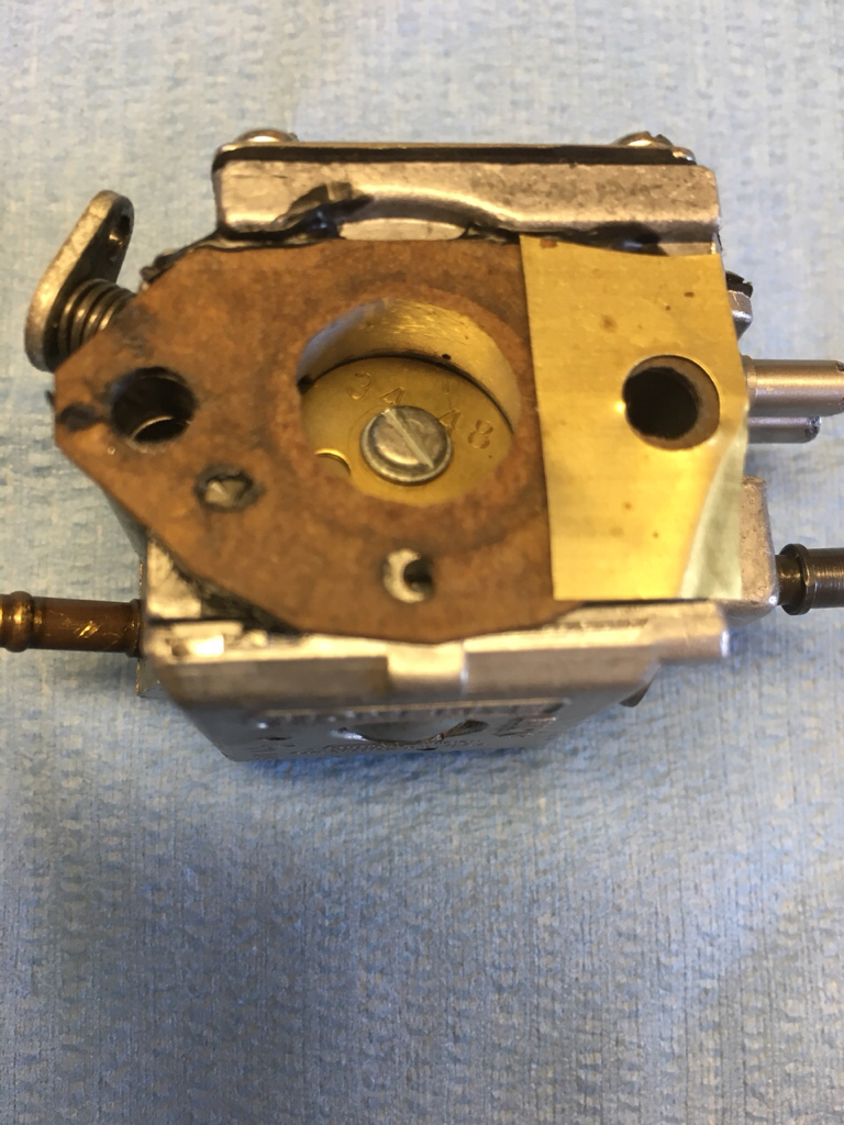

Carb is a Walbro HDC with an ‘accelerator circuit’ per my Clymer repair book.
Since it is obviously sucking fuel from the ‘accelerator circuit’ can I just block it off at the carb face?
I just replaced the carb with one doing the exact same thing.

I think it’s sucking fuel thru passage ‘P’.

Blocking off the ‘accelerator pump’ circuit with .003” shim stock did nothing.

And, we left the ‘accelerator pump’ passage blocked off. It is not really needed and adds a potential for malfunction.[emoji848]
Plus we are lazy.[emoji6]
