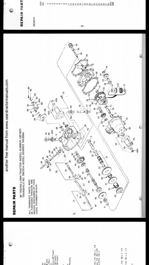

I found a tear down manual on line. Still hard to teel exactly whats what but after about an hoir or so and taking gears in and out about three times i think i got it figured out. The tranny / rear end bolts are in boys shed so will wait till tomlrrow and get them and tighten it up. And make shure its gonna work propper befor i put rtv silicone on it to seal it up.
Hardest part was figuring out the shift forks.

Heres the tranny / rearend teardown if anybody else needs it.

Well i havnt got sometging quite rite. I have three forward gears but no revers. Gonna have to tear into it again. Starting to get frustrating.
