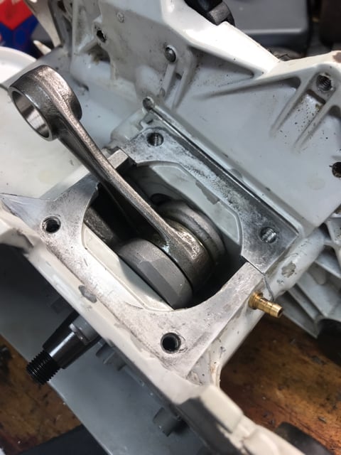

Finally got my car back on the road. Took time tonight to clean case halves up and install new bearings. Maybe I’ll have more chances to work on it.

can you do me a favor....can you measure (in mm) the diameter of the threads on your clutch side of the crank? just curious :)

Installed crank in case.
Found the failure due to crank bearing going when I went to put piston on crank. Piston skirt is missing.

@Mattyo
Farmertec crank
Clutch 11.82mm
Flywheel 9.76mm
HL Supply crank
Clutch 11.71 mm
Flywheel 9.75mm
did you install the hl supply crank in the case? is that the one in the pix above? did you use the tool?
11.71 is a little small for the OD on the clutch side... 11.9 is the spec I think for proper m12x1.0 threads.
