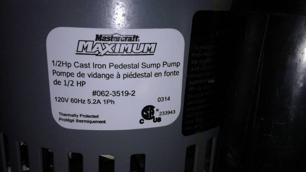

This is all that i seen on the pump. I think my generator is just too small.
Will have to mabe sgop around and invest in a bigger one. Probly around 5000 watt continuous.
Any sugestion as to what brand without breaking the bank. Curently have a coleman power mate thats been flawless just under power for the pump.

Your gen should run that easily 5.5 amp 500 watts like 5-8 lightbulbs
