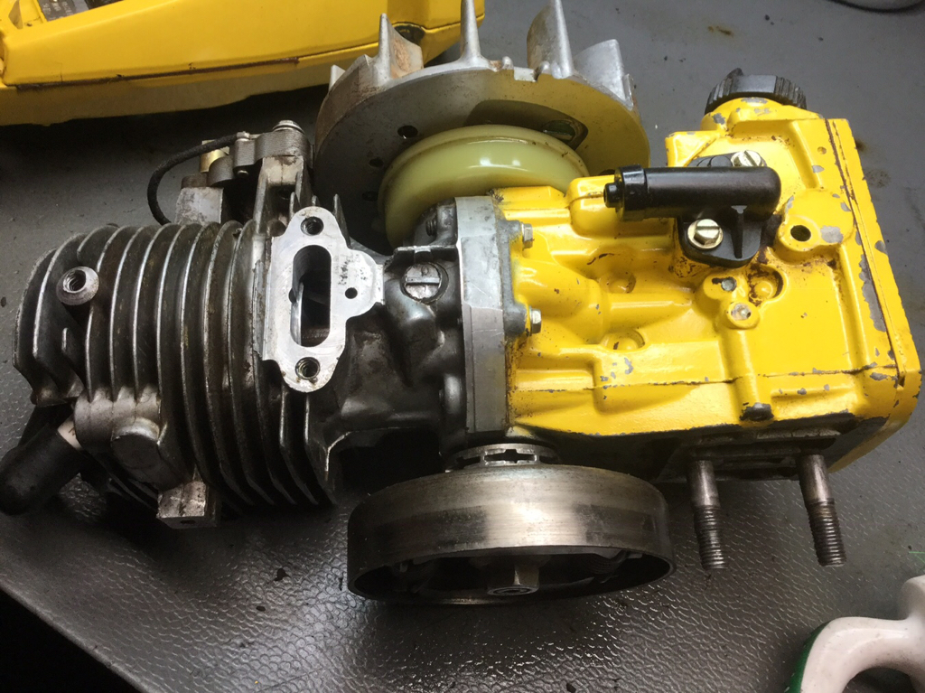

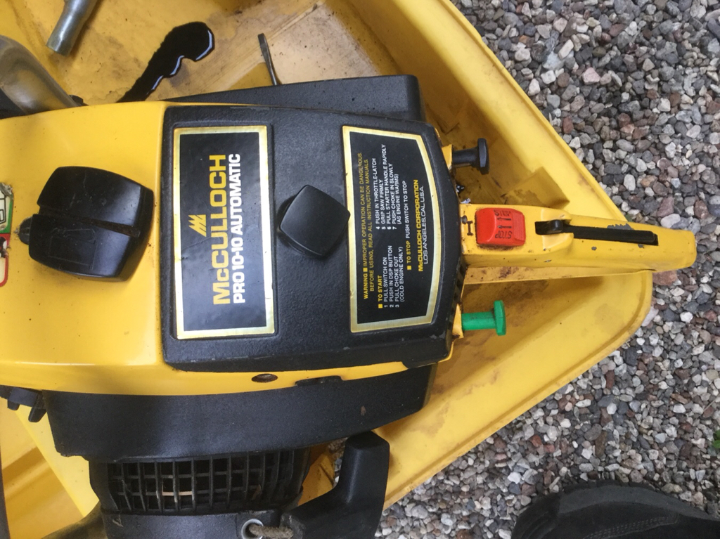

I got this 10-10 handed down and she’s really clean and totally complete
A few months ago I did a prelim tear down and replaced the gaskets.
I believe she help pressure and vac but don’t remember.
She starts on the 1st pull but lacks balls in the cut.
Became hard to tune after a few cuts.
(Seals?Rings?Both?Tune?)
I’m thinking about throwing up my hands on this one.
Any recommendations ope?

I guess it never did
@mirage check out my YouTube channel Sept '19 under McCulloch 10-10 and McCulloch 10-10 take 2
All issues were taken care of, bearing, seals, piston & rings, carb, ignition etc. with NOS parts.
This being a standard 10-10 motor, not a pro mac, as the insides didn't match the outside, unfortunately.
